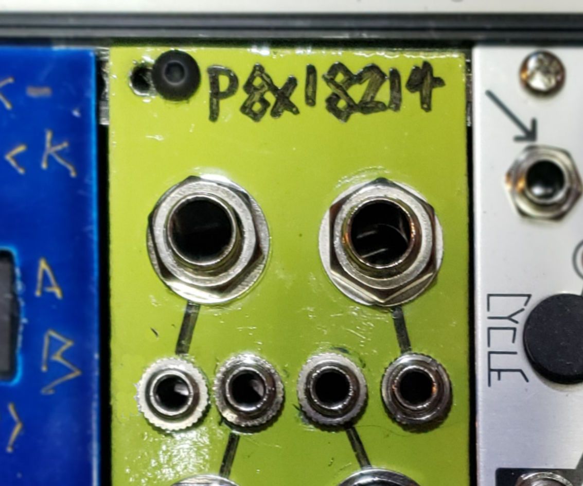

I've both laid the circuit out on a breadboard and included a photograph of my unit's innards. The SparkFun breakouts make for a convenient way to drop the sockets into place but aren't really necessary as you can see in the photo. My permanent unit is built on strip board but the variety of potentiometer and possible jack sockets you might use are so great (and mine turned out to be such a klunge sausage) that I didn't even try to include a layout that way. You might use something like this for a permanent version if you don't want to go through the drilling/routing/bridging headaches I've gone through the last few days.

I built mine so that it is powered by USB but if I choose I can pull it out of the project enclosure and put it into my Eurorack rig pretty easily. If you want to power it using Eurorack you can use the scheme I detailed in my PacificCV Controller Instructable. Also, as you can see, I found a source for the busboard style headers to use in my Eurorack modules here. (I bought them out though.)
If you build a permanent model, mount it depending on how you choose to build it up and want to use it. If you choose the Eurorack version, you can use my Useful, Easy DIY EuroRack Module Instructable as a guide for creating a panel. If you use PCB mounted jacks and trimpot, I'd recommend making a cutting guide, using a piece of cardboard the same size as the face onto which you plan to mount the unit. Starting with the piece that projects the farthest out from that face, trace and cut holes to fit each component (eg, draw the outline of the potentiometer, then punch the hole out and trace the outlines of the jacks with the pot sticking through its hole, cutting those, and so on.)
