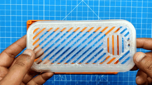

The base lid part is modeled with a large opening in the middle. In this opening, we will add a grill for air ventilation, This grill part is printed from transparent PLA, and the lid itself is printed with orange PLA.

- Back Lid Grill: Transparent PLA with a 0.6mm nozzle and 0.2mm layer height

Step 13: Lid Part Assembly
- With the lid assembly, we simply set the grill part on the back lid part and slide it into position by applying pressure to all of its edges.
- We then permanently join them together using superglue.
