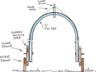

Glue and screw a cleat to the inside of the outer frame, its top 1" from the top of the outer frame. Mine was scrap mahogany, roughly 1" x ¾".
The cross-section in the photo shows how the whole thing comes together, with the inner frame resting on the cleat of the outer frame.

With the inner frame raised on a pair of sawhorses so the hoops can extend below the frame, clamp one of the PVC hoops in place, eyeballing it so that the height looks right, and the bend in the hoop seems centered. Mark the length with a Sharpie, cut the excess off at the bottom of the frame, then drill a pilot hole for a 1/4" hex bolt to hold the pipe in place. Using this first hoop as a guide, cut the other two hoops to length, then clamp them in place and secure them each with a ¼" hex bolt and washers.
Important: with one side of the hoops secured, slide the ridge stick in place before securing the second side of the hoops.

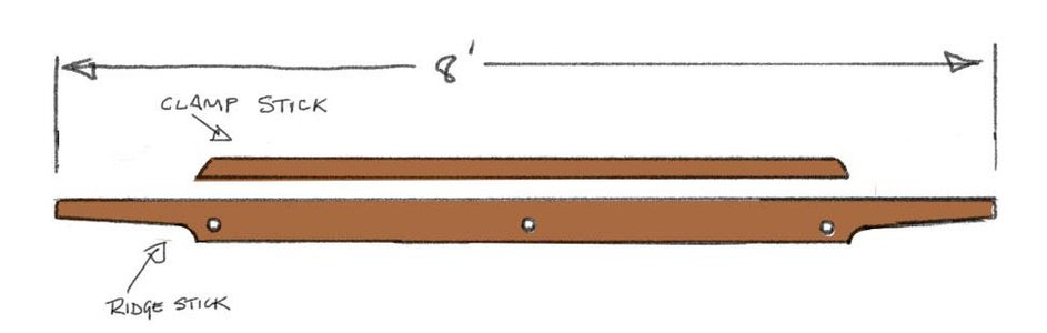

Step 4: Ridge Stick
As per the supplies list, rip a 4" strip off of the 1 x 6 piece of pressure treated wood. Measuring off of the inner frame, drill three ⅞" holes about an inch in from one long edge, one in the dead center of its length and one toward at each end, so the PVC pipe hoops will fit neatly in the corners of the inner frame (see drawing).
You could leave the overhanging "handles" plain, but I decided to dress them up a bit by cutting a handle that narrowed towards the outside (see photo). If you hate pressure-treated wood splinters, round over the ridge stick with a router. I used leftover mahogany to fashion a clamp strip, and routed the top and sides of that, leaving the top of the ridge strip and the bottom of the clamp strip flat, to leave as much mating surface as possible for the screening. If you want to be fancy, you could create a tongue-and-groove to really lock the screening in place.
