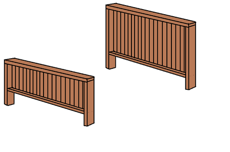

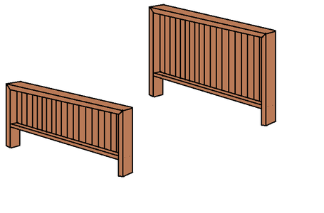

I measured the mattress to determine the basic size.
39" W x 75" L
I decided on a cabin style headboard and footboard. The basic design is an outer edge sandwiching the back slats into a slot with glue.
The entire structure is made from dimensional pine lumber.
The inside width is 39". The total width of the headboard is 39.5".
The side rails are 14" off the floor.
The total height of the headboard is 39.5". The total height of the footboard is 24".

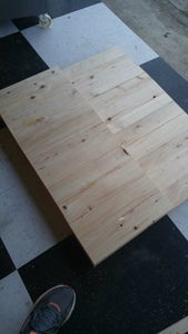

I used a thickness planer on all of the boards to remove any slight warping and cupping that was in them. This will also make for a tighter fit when I glue the boards together.Additionally, this saves a large amount of time sanding.
Step 3: Glue, Sand, Assemble the Insets
Because I rushed the cuts, I ended up with several uneven lengths. I simply glued and clamped the boards. When it was dry, I cut off the uneven edges. I did this for the headboard and foot board inserts.
At this point, I did a final sanding. I also kicked myself a little for not wiping the excess glue off before it dried, as it was kind of a bear to get the dried glue off.

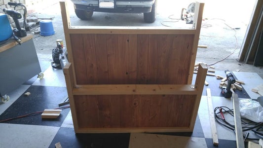

Step 4: Uppers, Bottoms, Legs
I used my table saw to cut a channel matching the thickness of the insert boards into the upper and lower boards of the headboard and the foot board.
I used some glue in the channel and installed the lower inserts.
I cut a 45 degree angle into the upper board to allow for a angled joint. I did this because it created a more finished edge.
I glued these in place and added a few nails for good measure.
After the glue dried, I added the legs. These have a matching 45 degree angle, but no channel. I installed dowel pins into the corners to secure the pieces.
Lastly I used angle brackets on the bottom of both head and foot board for a little extra structural integrity.

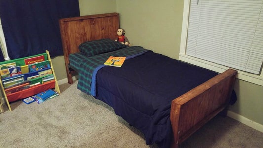

After allowing the bed set to dry in the garage for a day or two, I moved it into my son's bedroom and assembled it.
Overall, I am very happy with it. I think this will last him for many years to come. Additionally, the height allowed for some below bed storage that was not available with his old bed.
