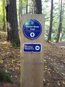

My first idea for the location of a small bridge was a stream in the woods near my house. I had regularly crossed that stream as a child going hiking with my parents, and it was sometimes a struggle when the rocks were slippery. However, I ultimately decided that it could be easily remedied by a simple construction of wooden planks even though I already made a fully fleshed out design incorporating Generative Design with Fusion 360. So, I just include it in my submission to show my design process.

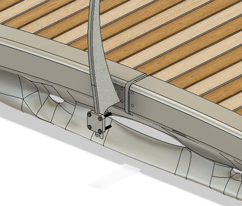

I wanted the bridge to be simple to assemble, strong, and semi modular, so I settled on making 3d printed side arches that held wood planks between them.
I started by drawing preliminary sketched on graph paper. I decided to use only five railings, with a curved top section, and wires running through below. For the final design, i removed the wires, and kept the top section, as I liked the more simplistic look it offered. My initial plans were to print the bottom section in concrete, but I decided to use metal instead, like on the DAR bridge. Concrete 3d printers usually have larger nozzle sizes and layer lines, leading to a lack of precision compared to metal deposition machines.
One of my main goals was to make the design modular and easy to construct. Each railing can be plasma cut out of a single sheet of steel, and only needs to be welded to a small plate to mount to the bridge assembly. The part slots into the 3d printed steel housing, allowing for a seamless fit. It's then possible to screw the railing into the bridge using the four holes in the steel plate. To protect the screws from rust, and to give the bridge a more streamlined shape, I designed a smooth cover to clip over each railing mount (visible in the rendered image).

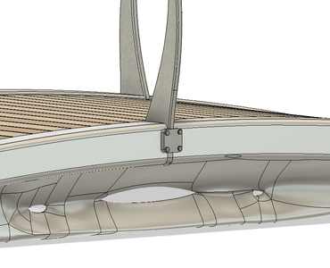

My plan for the supporting arches was to use generative design to create an organic supporting shape that could help the bridge keep its weight low and be feasible to manufacture. I started by creating a sketch, and drawing an arc that spanned around 30 feet. I then offset the arc, and closed the shape by connecting the offset line with the original arc. Exiting the sketch, I extruded the shape by a foot to create a 3d object. Now, I filleted most of the edges, and prepared to include the bridge deck.
Creating the wooden beams:
To create the deck of my bridge, I planned to use a row of two by fours inserted into the side arches. To do this, I created a single beam spanning five feet, and placed it at the edge of the side arch, perpendicular to the shape. I then used the pattern on path tool to create 45 beams in total. Since I wanted the beams to be locked into the 3d printed arch, I moved all of them into the shape, and used the combine tool to perform a boolean operation, cutting the shape of the beams away from the arch.
Using generative design:
I switched to the generative design space, and created a new Structural Component study. I selected the arch as the shape I wanted to keep (I didn't set the beams to obstacle geometry since my computer couldn't handle it, I just cut the shapes out of the finalized generative design). Since the average person weighs around 137 pounds (source), or 610 newtons, I added three forces to the arch pointing perpendicular to it's surface, as I expected a maximum of six people to be on the bridge at a certain point in time. Once the design finished computing, I mirrored the organic bridge supports, so that both the sides were assembled (see first photo).

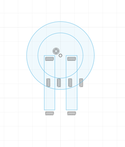

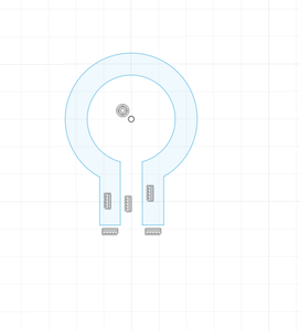

Creating the base profile:
To create the hooked handrail design, I started by making two splines, each slightly offset from the other. I made the base of the double spline area fatter than the top, and ended the top spline in a sharp line pointing down. I created another line pointing from the bottom spline, so that the two lines would intersect. I then filleted all of the edges to create a more smooth and less aggressive profile. I exited the sketch, and extruded the body by one inch.

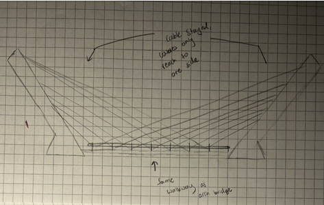

Because the bridge would have to span over 200 feet, I decided to use cables to help with the weight of the deck. I first designed an arch style bridge, but then decided to make a cable-stayed bridge, with large abutments on both sides carrying the weight of pedestrians.

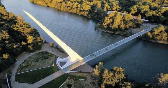

My initial design was inspired by the Margaret McDermott Pedestrian Bridge, where I constructed two huge arches, which supported the deck through two dozen cables. My second design also used cables, but it was more similar to the Sundial Bridge.
Step 7: Design
My goal for the second bridge was to design a large, mechanically sound, and good looking bridge. I started my plans by drawing possible designs on scrap paper. The first one was a dual arch design, but I quickly moved on to the second iteration. The deck is suspended by cables, which are mounted to the large concrete pillars at each bank to hold the weight of the deck.
Since these pillars were angled back, they are able to lift the bridge structure through their weight alone. Normally, there might be other cables pulling from the top of the pillars away from the bridge, but since the bridge experiences a relatively light load (pedestrians, not cars), the weight of the concrete is sufficient to counteract the cable tension.

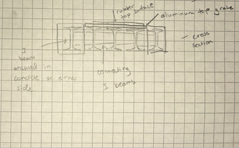

The deck is over 200 feet long and suspended by the cables tied to the pillars at each bank. Yes, the deck needs to be robust, safe, and durable through well engineering. I settled upon using steel I beams to bridge the gap, while placing reinforcements periodically and plates above for walking.

Using the sketch menu, I created the profile of the I beams using the “Line” tool. I then exited the sketch menu, and extruded the shape using the “Extrude” tool to form the long 200 foot beam. Using the “Rectangular Pattern” feature, I made four copies of this beam in a horizontal line.
To make the concrete side panels, I made a new sketch on the end of an edge I beam. I made a rectangle using the “Rectangle” sketch tool, and extruded the rectangle (minus the geometry of the I beam) a couple feet.
To create the rest of these concrete side parts, I made a pattern along the length of the I beam, and mirrored them to the other side of the deck.
To make the deck panels, I used the sketch menu to create a large rectangle, and extruded it a quarter of an inch. I spaced these apart when duplicating to allow for thermal expansion (calculated below)
Actual Construction:
After looking at what other bridges of similar size used, I decided to use five W21 beams spanning 200 feet each to provide the main support. Along these beams, short supporting I beams (W16x100) would be welded to join the longer structural beams together. Since the supporting cross beams are a tiny bit smaller than the W21 beams, they fit perfectly between the flanges of the longer beams. Ideally, these would be welded, though it might be better to use sliding bolts to allow for more thermal expansion.
Thermal expansion is a large issue on bridges, especially where I live. Temperatures often drop to below 0F in the winter, and rise past 100F in the summer. Because of this large temperature range, bridges must be designed with thermal expansion in mind. As the temperature changes, the deck will flex, and the large aluminum plates that cover the deck will change in size. Because of this, each plate is offset 0.25 inches (calculated thermal expansion given the area of the plate) to ensure that there aren't any problems.

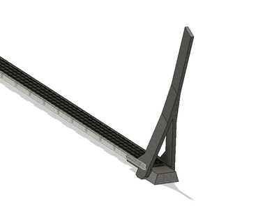

My goal for the bridge pillars was to make them visually appealing and distinct as well as structurally solid, so I went with a sharp, tilted and angular look.
CAD Details:

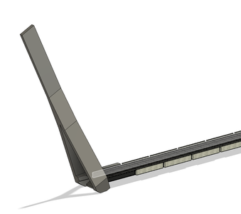

To start making the pillars, I created a sketch of the basic profile. I wanted a more angular look, and hollowed out the interior to allow for easier pedestrian traffic. I then decided to tilt the whole structure backwards. This improved the look of the bridge, and more importantly, allowed the weight of the concrete and steel pillars to counteract the weight of the bridge (the cables would be attached to the top of the pillars, and pull inwards to the bridge).
As shown in the fourth picture, because of the weight of the bridge, there would normally be another cable put along the counter force arrow to counter the load of the bridge. In my bridge, this force is provided by the weight of the tilted back pillar.
This would be the hardest part of the bridge to construct in real life. The pillars stretch over 50 feet, and are intended to be made out of steel impregnated concrete.
These would likely be constructed at the work site, instead of being made at the factory, due to their immense weight and size. A method called slipforming would be used to form the concrete around the metal pylons. This method pours the concrete down onto a mold that is moving higher as the concrete solidifies. As the concrete sets, the platform containing a constantly changing mold moves up a step, and changes into the right shape for that segment. After a certain amount of steps, the structure is fully completed
If needed, the concrete will likely be post tensioned, which is when steel wires which were previously run through the mold are pulled together, compressing the whole structure, and leading to greater strength and reducing wear over time.

Step 22: Green Walkway Design
Overview:
The green walkway is a crucial part of the bridge design. Plants grow under the ramp, and come out through the grates on either side. The plants help me make my bridge as sustainable as possible, which is one of my main goals for this project. The greenery contrasts with the industrial theme of the pillars, and helps the whole structure fit in more with the rural New Hampshire feel.
I decided to go with a ramp as it was the most accessible option to everyone. The ADA (Americans with Disabilities Act) states that any ramp must have a grade no more than a 1:12 ratio. This means that to drop one foot, a ramp must be at least twelve feet long. Note that in this case, length means horizontal distance, NOT the length of the surface.
CAD Details (Steps shown in fourth picture):
  1. I started by making a sketch on the pillar, where I drew a very thin rectangle using the “Rectangle” tool. Since the back of the pillar is curved, by extruding this rectangle using the “Extrude” tool, the ramp gets a slight tilt. At the end of this extrusion, I made a new sketch on the side of the ramp, and drew a straight line upwards. I then excited the sketch menu, and using this straight line I cut the previous body using the “Extrude” tool. This made the edge of the ramp perpendicular to the ground, and allowed me to start a curve.
  2. Using the flat surface created in the previous step, I once again used the sketch menu to create a curved ramp. I made two circles using the “Center-Diameter Circle” tool, and cut them off using the “Line” tool, creating a quarter turn. I then excited the sketch menu to extrude the object and join it with the ramp.
  3. Next, I completed the ramp by extruding the last face all the way until it hit the ground. Before doing this step, I verified that the incline was less than a 1:12 grade.
  4. I decided that the curved ramp didn’t fit the rest of the bridge's design, so I edited the original sketch in the timeline to create a sharper shape. I also used the “Appearance” tool to change the material from the default steel to marble.
  5. Since the ramp can't support itself on such a thin surface, I needed to construct a foundation underneath. I began by starting a sketch on the ground plane (using the base of one of the pillars). I then used the “Project” tool to create the profile of the ramp on the ground plane. Exiting the sketch menu, I used the “Extrude” tool to extrude the created sketch to the faces on the underside of the ramp.
  6. To create a grate effect, I needed to first hollow out the bottom shape. I used the same sketch as before, and used the “Offset” tool to create thin walls close to the edge. I extruded these shapes to cut into the previous solid shape, making an air gap between the outer wall and the inner wall. Using a free Fusion 360 Voronoi tool extension, I created a sketch on all the outer edges of the ramp. I then extruded every voronoi object into the outer shell to create the organic grate design. I then colored the inside wall gold to create a nicer background color.
  7. During the voronoi creation process, some cells were missed, so I edited the original sketch to draw in every missed cell. Since I had only created one ramp, I used the “Mirror” object twice to create another ramp on the other side.
The top of the ramp would most likely be built out of sheets of steel welded together. The bottom supports would also be metal, including the grates, but there would be a substantial amount of soil at the bottom to support plant life. This soil would likely also help the stability of the ramp while also providing space for the plants to grow.
The garden would need to be planted in a couple different stages. You should start by removing any large rocks, and verifying that there aren’t any utility pipes close to the surface of the ground.
Since the garden area is a long strip mostly in the shade, plants will need to be able to grow out of the grates to reach the sun. It would be a good idea to plant some ground cover plants, and also some fast growing taller plants that can stretch through the grill. In this example, I’ll use Japanese Spurge (short plants to form a mat), and English Ivy (tall plants to reach the grill).
Then, you need to pick out the correct type of soil. For decorative plants, loam soil (a mixture of sand, silt, and clay) is perfect. A pH (acidity) level of 6.0 to 7.0 would be perfect for these plants. In case the pH of the soil is unknown, it would be useful to bring pH testing kits and pH adjusters in case the acidity is undesirable.
Before placing the soil, it’s important to get rid of any weeds or pests in the garden location. Then, it’s good to loosen the current soil (to mix it) using either a garden fork or a rototiller. You should aim to loosen the soil to a depth of around 8 to 12 inches.
Next, you should place a thin layer (2-3 inches) of compost over the old soil. This helps to add nutrients to the soil, and encourages faster plant growth. On top of the compost, layer around 12 inches of topsoil, and mix everything (topsoil, compost, old soil) using a spade or a garden fork.
After mixing the soil there needs to be a level surface for plant growth. Using a rake, try to make a flat surface, while also breaking up any large clumps of soil.
Next, you need to transplant the plants from the pot into the garden. Starting with the Japanese Spurge, a transplant would be most effective during the early spring, as that is right before the plants experience major growth. In the garden, cut out holes spaced 6-12 inches apart the same size as the transplanted plants. Since Japanese Spurge can quickly widen to totally cover the ground, it’s ok to space them fairly far apart. The holes only need to be a couple inches deep, as this plant’s roots are very shallow. After inserting the transplants, put a small ring of mulch around each plant, making sure not to cover the actual plant.
For the Ivy, you should dig holes a couple inches deep spaced around 18-24 inches apart, allowing sufficient room for growth. Add a layer of mulch around the plants (a similar process to the Japanese Spurge), and ensure that they receive plenty of water for a couple months.
Both plants need to be watered and taken care of for a couple months after the transplant, to ensure that they can successfully grow and adapt to their new environment. Both plants should be fine after that period of time relying on just natural rainfall. The Japanese Spurge should form a thick carpet underneath the ramp, while the Ivy should spread up and through the grates to reach the top of the ramp.
Sustainability:
The plants grown under the bridge help to offset the emissions produced in the manufacturing process. They can also purify the air near the town.
