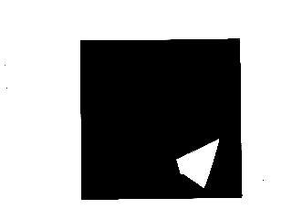

Grasshopper's Firefly plug-in allowed us to stream the webcam in real-time and take snapshots every time the robot was in the defined photo spot. We then converted this image into black-and-white to facilitate the processing. Then, we used the Rasterize component from Peacock plug-in to retrieve the piece contour curve.
We also needed to locate each piece within our scanning area. To facilitate this process, we created a black square frame with white edges, in which the user can freely place the piece. It is very important that this frame is fully included in the picture, so that the result of the rasterization is the piece contour curve in relation to the contour frame.
The dimensions of the frame enabled us to then scale the resulting contour curve, and move it to the right position in our digital model.

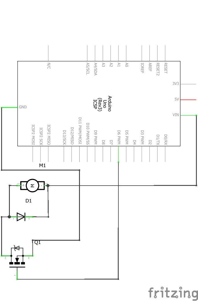

The next step is to build your electronic circuit according to the attached wiring diagram. We highly recommend testing the components individually before fixing the circuit inside the effector. For troubleshooting, we provided a simple Arduino code that will activate and release the suction pump every 5 seconds.
Once the circuit is ready, securely fasten every component inside the two plates you built previously using duct tape, superglue, or screws.
