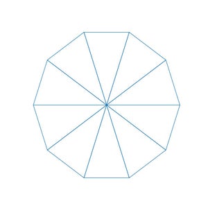

Step 1: Circle Is a Polygon With Infinite Sides
We can see in the above figure. As we go on increasing the number of sides of the polygon its shape starts to look like a circle.
When the number of sides of the polygon is equal to infinity it becomes a perfect circle.

Step 4: Decagon for Calculations
Let us consider this decagon for the explanation and calculation of the 𝞹 (pi) value.
It has 10 sides & 10 diagonals.

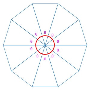

Step 5: Angles (θ) of Polygon
Let us consider the angle between any two diagonals of the polygon as theta(θ).
Theta = 360 / no of sides
for decagon :
θ = 360/ 10
θ = 36°

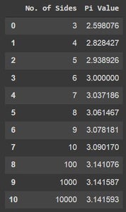

Step 16: Increasing Sides Reduces Error
In the graph shown above. It is a graph of the 𝞹 pi values calculated versus the number of sides of the polygon used to calculate that value. The more the number of sides the more accurate the value we get approximated to 3.14159.
The table has the values of the number of sides of the polygon and the respective pi value calculated from that figure.

Step 19: Comparing Theoretical & Calculated Pi Value
The above image compares the pi value stored in the math library and our calculated pi value.
With the polygon of 10,000sides, we get the error of just 5.1677127910210174e-08.
