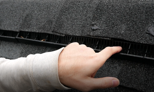

Ridge Length x Net Free Area of Ridge vent = Vented Area of Ridge
Vent area of the 2 soffits combined should equal the vented area of the ridge
