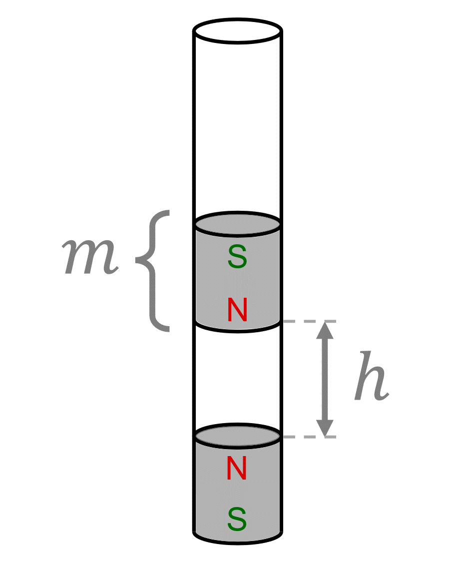

Place your tube on a table vertically (just hold it upright) and slide in your magnets from the top so that they're repelling each other. Depending on the weight and strength of the magnets there is a smaller or bigger gap between them. Measure and note the distance h as accurately as possible.

The upper (floating) magnet is experiencing the repelling force as well as gravitational force. As the lower magnet also experiences gravitational force, the gap between them is caused by the repelling force. That means that the repelling force of the magnets at the particular distance h equals the gravitational force of the upper (!) magnet:
Fm = Fg
=> Fm(h) = m * g
The potential energy of the upper magnet is calculated as follows: W = m * g * h
Since Energy is generally W = F * s, you can equalize the two equations and finally get:
W = F * s = m * g * h
=> F(s) = (m * g * h)/s
Just put in the measured mass (in kg), height (in m) and the location factor g = 9,81 kg/(m*s^2) and you get the repelling force in the pearticular distance s.
