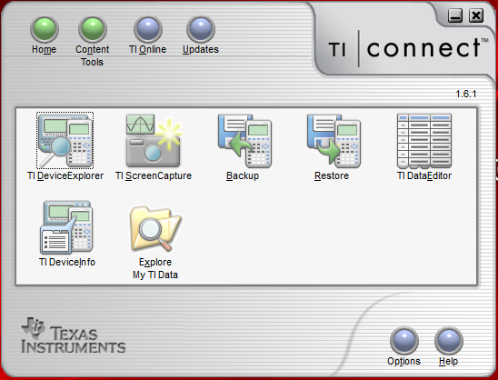

First of all you need a program to send all the programs. The one for windows is called TI-Connect. You can find it here.
Now install and run it (obviously :P)
It should look like this after the loading screen:

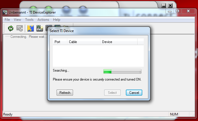

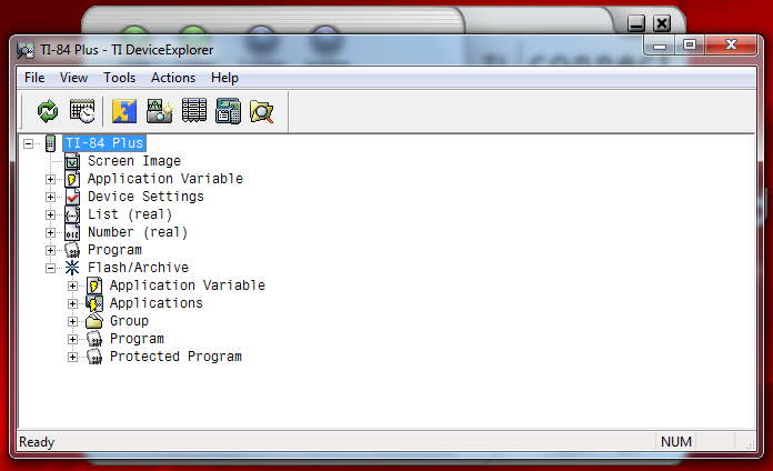

Now click on "TI Device Explorer".
It should as you for your calculator. Windows will need to install drivers in order that TI-Connect can link to it, it should be working all automatically, it will just take some time. If it still doesn't find any calculator try a different USB-port.

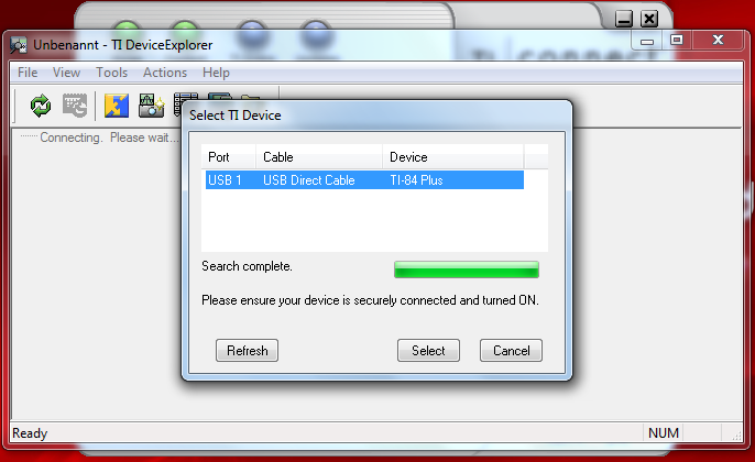

Still loading... There's my calculator!
Now I just have to hit 'select'.
This is how it should look now like

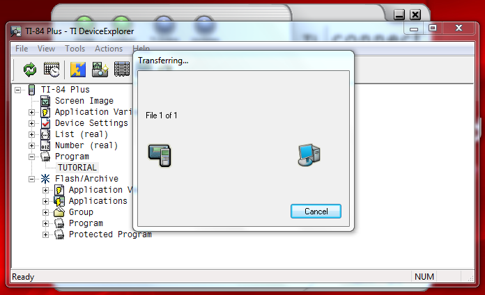

Now it's very simple to transfer data from and to the calculator. You just have to navigate through the menus to find your program and then just simply drag&drop to the desktop. To put files on the calculator just drag&drop them into this file browser.
If it could just load quicker... This is what a normal program looks like on the pc.
Please not that you can edit the file name on the computer as you want, it won't change on the calculator.

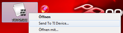

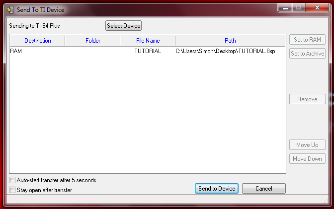

Now, there is also a other way to send files to the calculator without starting TI-Connect by right-clicking the programs and selecting "Send To TI Device...". TI-Connect will now start automatically in a different mode and will search again for your calculator, so have it plugged in! The menu for sending looks a bit different there.
Yeah, that is german... This is the different menu.
Just hit 'Send to Device' to send.
