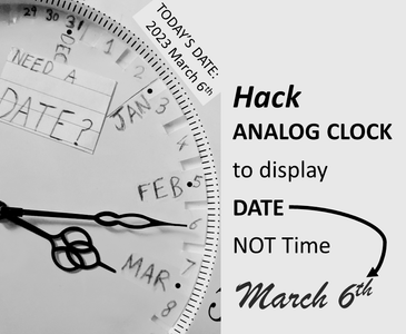

The idea for this project is to repurpose an analog wall clock to display the date instead of the time. The hour hand will display the month (1 to 12) and the minute hand will correspond to the day.
This hack involves slowing down the clock mechanism so that the minute hand only moves once a day and it takes the hour hand a whole month to move by an hour.
The Calendar Clock visually indicates how much of the year has passed by and can potentially incentivize people to plan their days and use time more effectively.

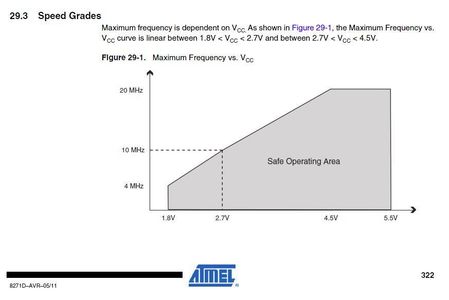

The quartz clock mechanism runs on a single AA battery (around 1.5V), thus to control the clock mechanism we need to send a 1.5V signal from the Arduino Pro mini. The digital pins can send a 1.5V signal only when the Arduino pro mini supply voltage (VCC) is close to 1.5V. But by default the Atmega 328p microcontroller in the Arduino pro mini needs around 5V as its clock frequency is 16Mhz, we can make the Arduino pro mini work at 1.5V by reducing the clock frequency to 1Mhz. This also drastically reduces power consumption.

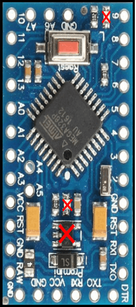

Since we are running the Arduino pro mini off a single 1.5V AA battery, we need to reduce power consumption by removing components such as the voltage regulator and SMD LEDs. These can be desoldered using a soldering iron or a screwdriver can be used to break these from the board.

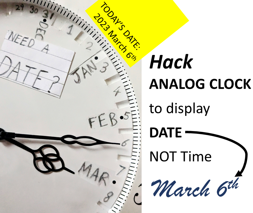

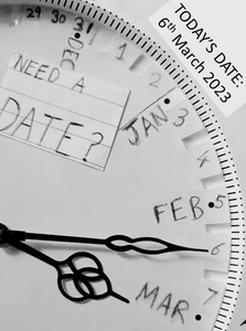

Step 5: Customizing the Clock Face
I have added dates from 1 to 28 to the location of every even minute. 29 to 31 are placed close to each other. The Arduino code moves the needle accordingly based on the date. For example, from 28th Feb to 1st March the minute hand is programmed to move extra steps compared to the transition from 1st March to 2nd March. I also added the text for months to make things a bit more readable, for the month of February the hour hand is between hour 2 and 3. The year starts at hour 1.
