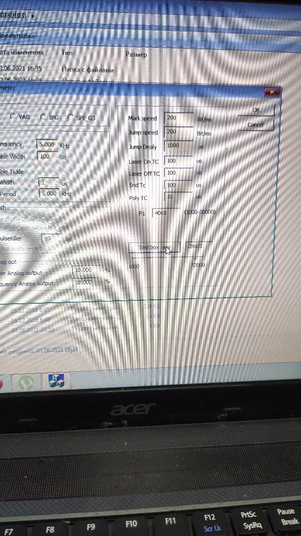

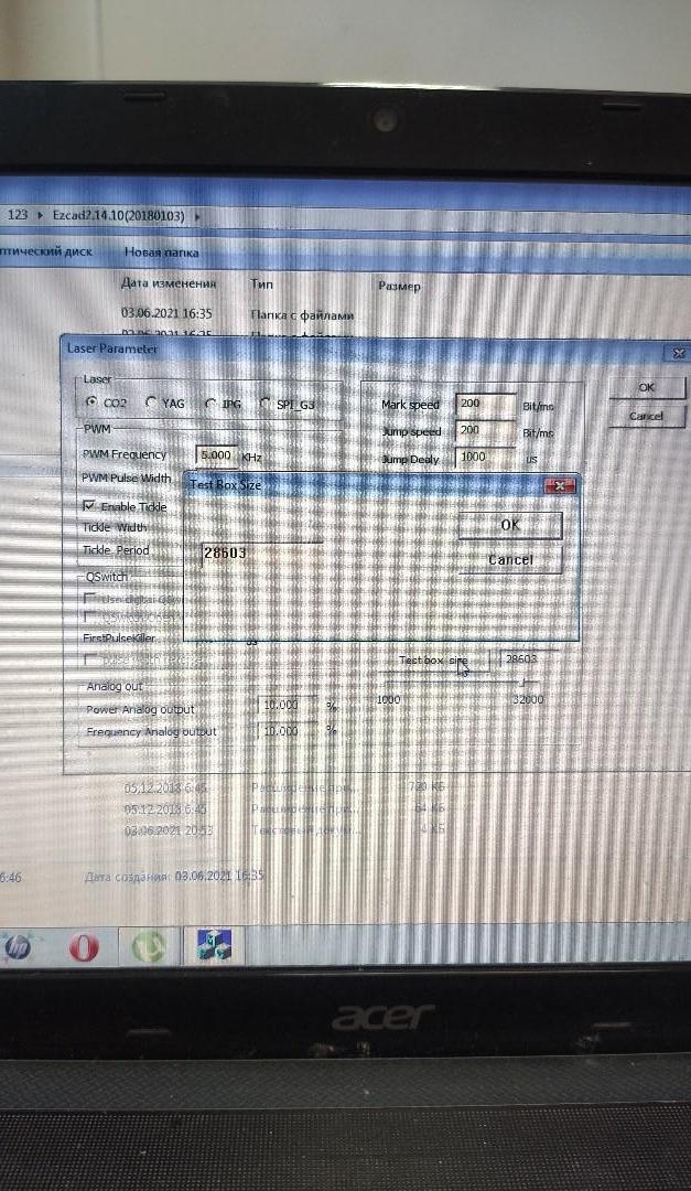

Step 4:
At the bottom right in the Test box size window, we proportionally decrease or increase the number (either by moving the slider, or by pressing the button, we fill in the value), we do it approximately. We need the calibration size of the square to be the size of the engraving field.
