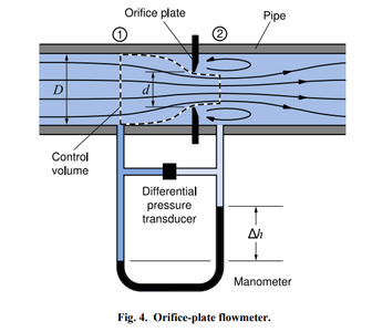

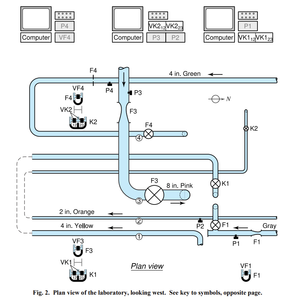

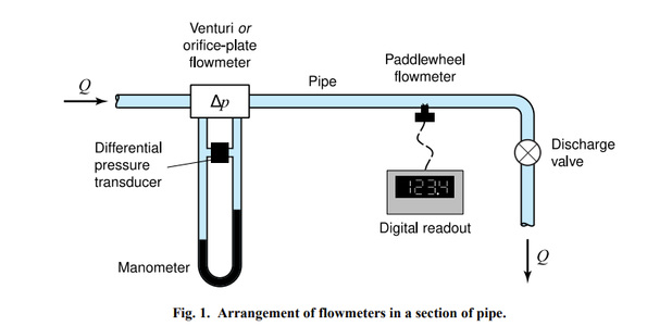

Your role requires you to interact with different equipment and materials. In calibrating flowmeters, you will deal with an apparatus consisting of a pipe. This pipe has a hydraulic flowmeter and a paddlewheel flowmeter. The hydraulic flowmeter used in our experiments is an orifice-plate type. It comes with a differential pressure transducer and a manometer that uses mercury and water to measure pressure differences. The paddlewheel flowmeter device that is connected to a transmitter that outputs a voltage. As water passes through the paddlewheel flowmeter, the paddlewheel spins. The transmitter senses the number of revolutions and outputs a voltage. During calibration, there is also a weight-time measurement that must be done, using a weigh tank, and a scale.

After completing preparation, you must calibrate the output voltage of the differential pressure transducer. This measures the difference in pressure from the orifice-plate flowmeter.

When acquiring data for the orifice plate meter and paddlewheel flowmeter, you must first prepare the paddlewheel flowmeter. The gain adjust control should be set to set to 6.25 turns for P1 and P4, and should be set to 3.00 turns for P3.
  1. Once preparations for data acquisition are finished, you may begin by opening the discharge valve. This must be down slowly until the allowable manometer deflection is reach, or the valve is open entirely.
  2. You must then make 3 recordings including
  3. Manometer readings, where you measure the heights of both sides of the manometer. Keep track of this maximum deflection
  4. Paddlewheel flowmeter readings, reading the voltage output
