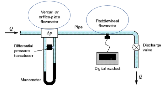

Calibration of bulk-flow measuring devices is vital to the accuracy of measurements and ultimately the products we iterate as engineers. Quantitative metrics for flow can be determined through analysis of physical properties of a flow through a system as that flow changes. This outline will serve to address the calibration of Venturi and orifice-plate flowmeters, which utilize constriction to introduce a pressure change in the system, and a Paddlewheel flowmeter which correlates flow velocity to a voltage readout. By analyzing the pressure differential in an orifice-plate meter, we're able to determine flow coefficients and tailor functions for flow rate to the system in question. The figure here depicts an experimental set-up with both flowmeters in a plumbed system, to give an idea of what the general structure of the materials for this calibration look like as you proceed with the analysis.

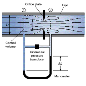

This specific analysis requires an orifice plate flowmeter with both a pressure transducer and manometer with taps placed before and in a constriction of the pipe. I trust in your experience as an engineer to know how to read a manometer, but if not, or if you'd like a refresher, please refer to the following tutorial [https://sciencing.com/read-manometer-5250401.html]. While the reliability of the transducer in our system set-up is fallible, it can be utilized for calibration but it'd likely be helpful to simultaneously check the manometer to verify the transducer's output. The paddlewheel flowmeter is found further down the pipe than the orifice-plate flowmeter, however in a section with the expected diameter of the pipe.

The goal of the manometer measurements and the weight-time flow rate determinations is to create a calibration curve depicting flow rate as a function of a pressure differential for the system. Manometer height differences and the fluid properties can be used to determine the proportional pressure changes in the system as the flow rate changes. The specific weight of water and mercury and the change in height can be used to determine the pressure difference and compared to the calculated flow rate from the weight time method.
Graph flow rate as a function of pressure difference for an orifice plate calibration curve.

Flow rate and the voltage output from a paddlewheel flowmeter should have a fairly linear relationship. In order to determine this, graph flow rate (as determined by the weight-time method) as a function of voltage for the calibration curve.

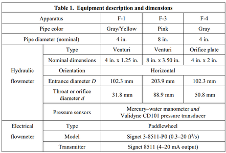

Step 8: Example Calibration Given Information
For this analysis, reference the dimensions and description of pipe F-4
