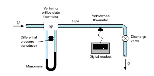

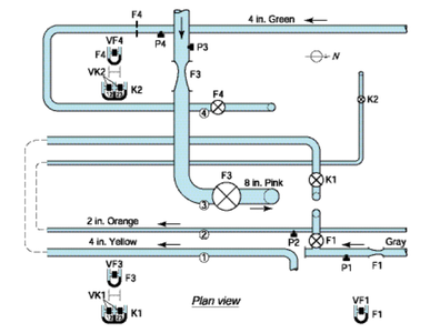

The two hydraulic flowmeters being calibrated include a Venturi flowmeter and an orifice-plate type, both of which are followed by a paddlewheel flowmeter, which is digital. Take note that throughout this process, the Paddlewheel voltage is being read automatically and the found hydraulic values will be compared to this one.
This general set up can be seen in the image pictured on the left, with the whole lab set up on the right.

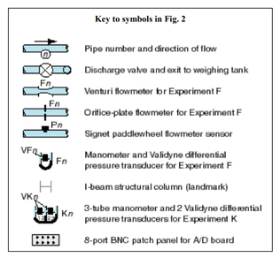

Above is the key that explains every symbol included on the laboratory 'Plan view' map.

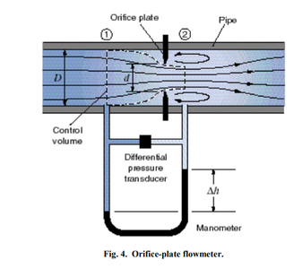

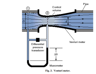

A Venturi flowmeter, pictured left, constricts the flow and gradually pans back out to free flow. Due to this gradual widening, there is no energy loss from flow suppression and energy of the system is conserved. For this case the discharge coefficient is equal to 1, which means there are no losses.
However for a Orifice-Plate Flowmeter, pictured right, there is an abrupt disruption of flow that supports energy loss and introduces a discharge coefficient that is not equal to 1.

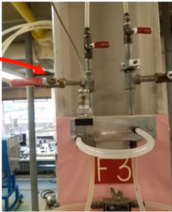

Use the valve (indicated with the red arrow) to create a pressure difference that leads to a height difference in the manometer. This data is completely collected as voltage readings that are controlled by the LabVIEW software where it is then stored as an output voltage proportional to the pressure difference.
This process is repeated 5-8 times for different pressure differences, producing a linear relationship between the pressure the transducer senses and its digital output.

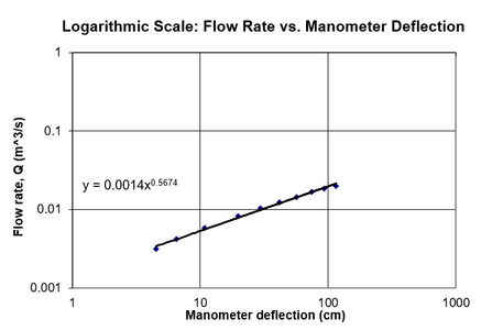

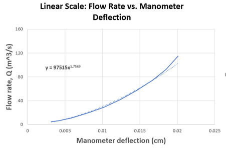

LR1) Flow rate can be plotted against the manometer deflection for either hydraulic flowmeter. Then the plot can be fitted with a curve, which becomes the calibration curve for the respective flowmeter. Shown above is the
LR2) If instead plotted using logarithmic scales, the new curve, flow rate vs. manometer deflection can be used as an alternate calibration curve. When analyzing the obtained graph, one can see the data fits the applied line of best fit well, implying a power law relationship like the type shown center, might apply.

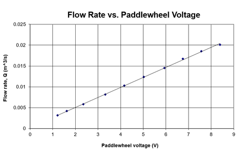

Upon plotting the voltage output of the paddlewheel against the actual discharge rate, Q, yet another calibration curve is obtained. Cutoff fluid velocities and maximum fluid velocity values can be calculated.

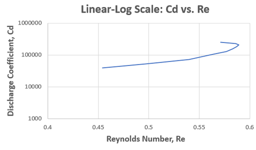

The image shown left is the discharge coefficient Cd plotted against the Reynolds number, Re. It was plotted using a linear-log scale, with the y-axis logarithmic, and displays how as the Cd increases, meaning more energy maintained in the system, the Reynolds number increases.
On the right, another calibration curve is shown, with paddlewheel flowmeter output plotted against the actual discharge rate, Q. The linear trend is constant with no rising or falling cutoff flow rates.

1) "Is the discharge coefficient Cd essentially constant over the range of Reynolds numbers tested? Are the experimentally measured values for Cd close to the ideal value of unity derived theoretically? What corrections might need to be made to the theory to obtain more realistic values for Cd?"
In this case, the discharge coefficient increases linearly on a log-linear scale with the Reynolds numbers until a Re of roughly 0.54. After that the trend is not constant. To obtain more realistic values for Cd one could test more trials and average their values. The flowmeter can be slightly affected by varying viscosity in layered flows, or from friction developed at a lower flow rate so to obtain realistic values it may be wise to test at higher flow rates.
2) "How reliable is the paddlewheel flowmeter? Was the reading more accurate at high or low flow rates?"
The paddlewheel flowmeter is reliable as it is a digitalized measurement system and removes any uncertainty from human error. It may be affected by varying viscosity in layered flows, or from friction developed at a lower flow rates passing through it, so the reading will be more accurate at higher flow rates, up until a certain maximum.
