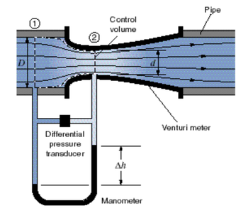

Step 1: Plotting Hydraulic Flowmeter Data (Linear)
When given the data from a hydraulic flowmeter experiment, you can easily plot the flow rate, Q, with respect to the manometer deflection, h in a program such as Excel. In this case, we are using linear scales on the plot to obtain information. Next, you can pass a smooth curve through the data using the necessary trend line option (power, log, linear, etc.), which is used as the calibration curve for the flowmeter.

Step 3: Discharge Coefficient Versus Reynolds Number
Next, you can plot the discharge coefficient (Cd) as a function of the Reynolds number (Re) on linear-log scales, which are two values obtained from the hydraulic flowmeter experiment. The Reynolds number for each test run can be found using the following formula: Re = (V1*D)/ v, where V1 is there velocity in the pipe, D is the diameter of the pipe, and v is the viscosity of the fluid. This plot can be used to make conclusions about the experiment, as discussed in the next step.
