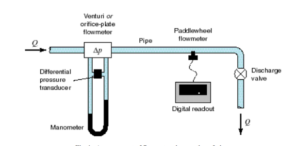

Each apparatus consists of a pipe with two different flowmeters, a hydraulic one, and a paddlewheel. In a green pipe mounted in the ceiling in Room 126 Talbot Lab where we will be conducting our work, plus a weighing tank located right below it. As shown in the figure, there are two types of flowmeter which are used to measure the same flow rate Q: a hydraulic flowmeter and a paddlewheel flowmeter. The hydraulic flow meter is read using a differential pressure transducer and a manometer, and the paddlewheel flow meter is connected to digital readout that displays the current. All of these flow meters will be calibrated compared to a weight-time method.

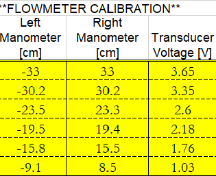

To set up the experiment, you will need to calibrate the electronic transducer against known static pressures. To create a known static pressure, you have a mercury manometer connected to bleed valves that are connected to our supply pipe. Open a bleed valve. By opening the bleed valve, you can expose one leg of the manometer to high pressure. Record the pressure difference between the manometer legs. Then, average the voltage of the digital pressure transducer and record the data.
Step 2: Finish the Set Up
Partially close the bleed valve to reduce the pressure difference between manometer legs. Record the pressure difference between the manometer legs. Average the voltage of the digital transducer and record the data.
This process is repeated 5-8 times for different pressure differences, producing a linear relationship between the pressure the transducer senses and its digital output.

Using the the flow rate equation, solve for the maximum flow rate which can be applied to both hydraulic flowmeters. The only thing varying is the discharge coefficient, Cd. For the Venturi it is 1 and the pipes gradual geometry change supports a system with no energy loss. However for the orifice-plate system, the energy is not conserved due to the abrupt disruption in geometry.
Step 5: Graphing Results
Using linear scales, plot the data points for the measured flow rate as a function of its manometer deflection for the Venturi flowmeter or orifice-plate flowmeter. It should similar to the graph below. The paddlewheel flowmeter voltage results are found to be proportional to the flow rate, which can be seen in the figure. Therefore, the voltage is also proportional to the velocity in the pipe, since Q=vA and the area is not changing throughout the pipe.
