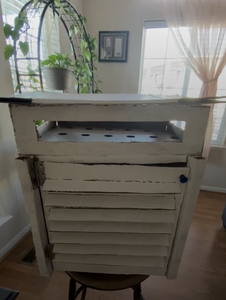

  2. Stevenson Screen (Instrument Shelter) 12 in x 12in x 9 in
Made of wood, with the louvered door design on 4 sides of the shelter.

Step 1: Making Stevenson Screen
Please follow the instructions https://www.instructables.com/Stevenson-Screen-weather-station/
Thanks to mattinflow for the great idea of the Stevenson Screen. For my students' Microbit weather station, a smaller instrument shelter will be perfect.
