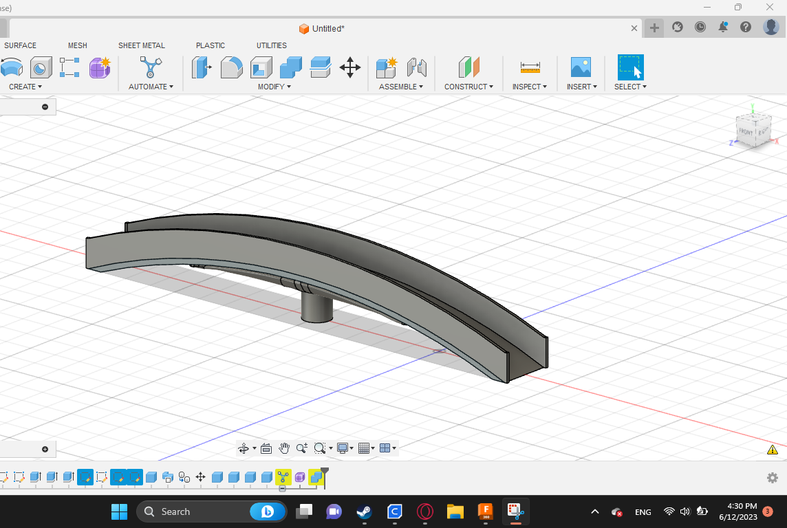

Step 2: Bringing the Image Into Fusion
This is the simplest step because all you have to do is send the image from your phone or webcam into fusion. First things first open fusion and open a new design. Then click on canvas as shown in the image above. Select the image you took in step one and press enter. It will prompt you to select the face you want to load the image on, click on the bottom face.
