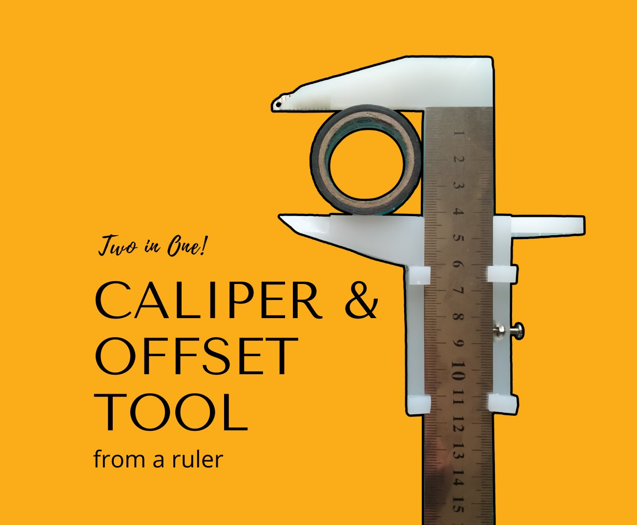

Usually when I'm making a project, I think of using a tool that helps me with accuracy. For example, when I want to measure the diameter of a pipe, gear, bottle, etc. which dimensions are uneven (non-flat object). And another problem arises when I want to create a guide line for the boundary of cutting objects, pasting other objects that are parallel to their outer borders.
However, in reality the tools on the market have a limited measuring length in the range of 16-20 cm and a limited function, namely only as a measuring tool that cannot be used to make auxiliary lines.
Because of that I want to make my own tools that I need, by pouring my thoughts into a design plan that includes the dimensions of the tool, the model of the tool and various things that support my needs.
Practical Inventions: Tinkercad helped me with this, so that my plans could be created and resulted in a very satisfying and working tool. I also think that this tool will be helpfull for an engineer to work with woods, iron, and plastic.
Caliper: Used to measure an object, especially a non-flat object
Offset Tool: Used to make a parallel line to an object at a specified distance. If you are familiar with Offset tool in AutoCAD, this offset tool works the same.
You can see the final product here.

After I made the design plan in Tinkercad, I made the actual product using acrylic palstic. Yes, No 3D-printer needed. It really works nad such a usefull tool for me. Learn how to make this caliper here
Because this tool was made using acrylic plastic, the overall method that I used was cut and joint. So you can also make this tool using a laser cut by downloading the model bello (SVG file). But if you want to make this tool using a 3D printer, download the STL file.
