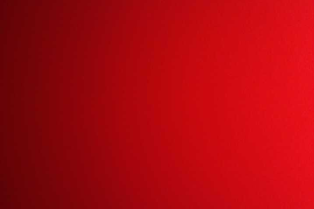

This project is using the IP Camera app to serve the data, so this is how it will look like:
