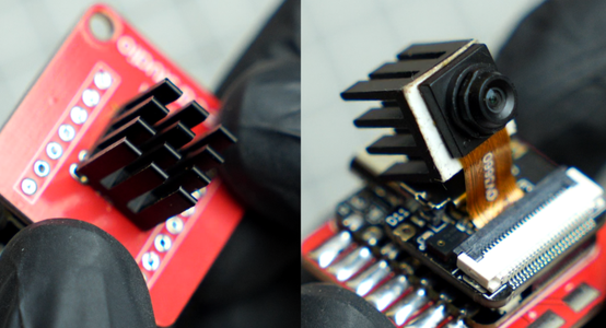

Step 2: Custom PCB
The XIAO ESP32S3 SENSE lacks a screw hole, making it impossible to install directly in your project without a PCB. To solve this issue, I designed a general-purpose XAIO PCB and utilised a Seeed Fusion service to bring the project to life.

The PCB files are available in my GitHub https://github.com/gokuxmaker/XIAO-PCB-

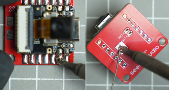

Step 3: PCB Assembly
Now, simply solder the XIAO onto the PCB. Additionally, solder the connections on the underside; this will help with thermal management. Finally, attach the provided heat sinks to the back side of both the camera and the PCB.
