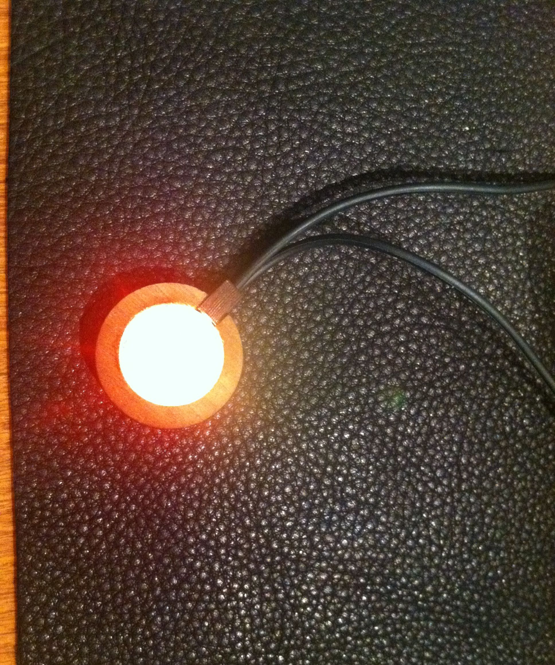

- 1 Pulse Sensor
- 2 pennies or other electrodes

The Light Blue Bean is a cute Arduino-compatible bluetooth low energy board that comes with a coin cell battery onboard. For this project, we connected two analog meters to the Bean, and soldered them together on the spare perf board on Bean. You can see a physical picture and circuit diagram here. To measure skin conductivity, we soldered two clean pennies to wire and connected them as shown in the circuit diagram: one electrode is connected to power, the other connects to a resistor that connects to ground. The user serves as a giant resistor whose resistance is measured in a voltage-divider setup in this circuit. Skin conductivity was input to analog pin 0. Our heartbeat meter was prebuilt with much of the amplification needed to get a good heartbeat signal, so that data went directly into analog pin A1.
You can see the way we attached our electrodes and light meter to our fingers: we simply wrapped them in a ring of velcro. The entire device, in fact, is strapped on to a velcro band on my wrist.
