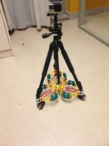

I will show you how to build a camera dolly out of K'NEX.

Step 7: It Is Finished. Put Your Tripod on Top of It.
You can arrange leafs according to your tripod. Put it and move your dolly :)
