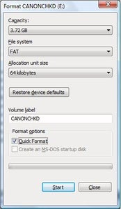

In Windows, open Explorer and find the SD card.
Right click, and select Format.
Under <File system> select FAT, not FAT32 (See picture)
     I am not sure if this makes a difference but it’s what they recommend.
Select Quick Format and <Start>.
This will take a little while.

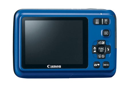

Now, here is some more tricky stuff. Canon point and shoot cameras are all a little different. You need to find the <ALT> key for your camera. Mine is the little Right arrow (See picture). You may need to read the Users Guide.
Press this <ALT> key to power up the camera.

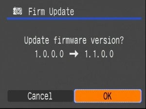

Press the <
MENU> button, then press <UP> once (or scroll down the menu list)
On <Firmware Update>, press <RIGHT> or <Func.Set>.
Press <RIGHT> to highlight OK, press <RIGHT> or <Func.Set> to do it
(See pictures).

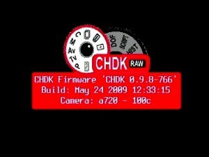

A little CHDK splash screen should appear. (See picture).
You should be set to use CHDK.
