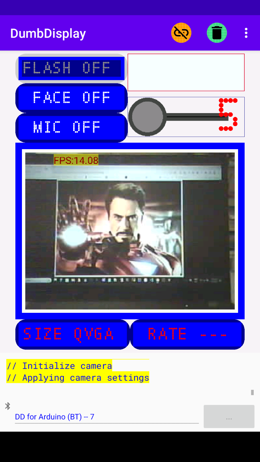

Step 1: The UI
As shown in the screen captures of the DumbDisplay UI for this experiment, around the area where the stream pictures will be drawn are several options that you can adjust
  • You can turn ON/OFF the "FLASH"
  • You can turn ON/OFF "FACE" detection
  • You can turn ON/OFF "MIC"
  • On the right top is a charting area, which is supposed to plot the look of the sound wave.
  • You can use the slider below the chart area to adjust the software-based sound volume amplification factor.
  • You can switch between the different camera picture sizes with the "SIZE" button -- "QVGA", "VGA", "SVGA"
  • You can switch between the different software-based "frame rate" throttling with the "RATE" button -- "---" (none), "1", "2", "4", "8"
