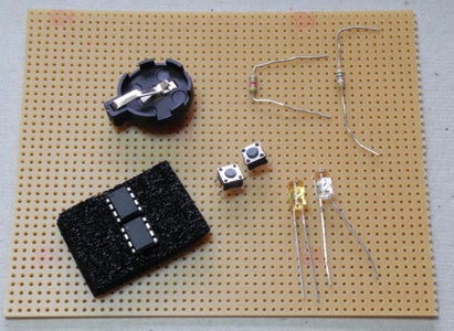

Step 1: What You Need
To built this device you need:
- some breadboard
- a cheap microcontroller (i.e. attiny85)
- an IR-LED, a normal LED and two resistors
- two pushbuttons
- a battery

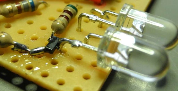

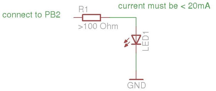

The schematic is quite easy. Only two inputs and two outputs.
I checked the resistor R1 to be 30 Ohm so that 40mA of current flows through the two LEDs. Depending on your LED you can use a smaller resistor or a larger one.
If you don't have, or don't want to use an IRLML2502 you can connect the LEDs like in the second picture shown.
Then you need to check the resistor to limit the current to below 20mA, as this is the maximum of what the microcontroller can deliver. In this case R1, R2 and R3, LED1 and 2 and the IRLML2502 are replaced by the second picture schematics.
Also R5 (10k) is optional, mine works well without, if yours doesn't: Try one.
If you don't want to reprogram the uC, then you can also omit the programming port. You have to program your uC in the programmer and then plug it in here.

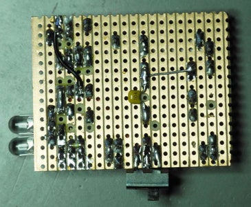

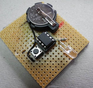

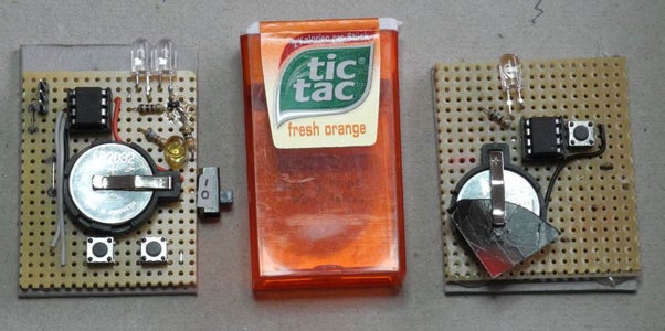

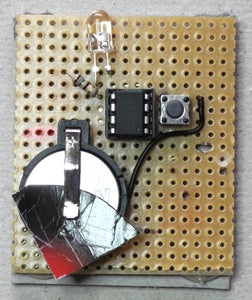

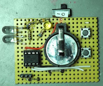

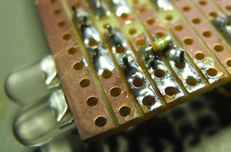

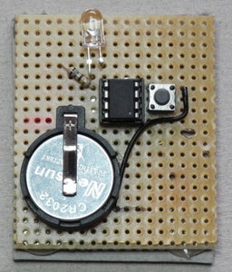

Step 3: Build the Board
with these few parts it is very easy to build the whole device on a breadboard.
You may want to try it on a solderless breadboard first, to test the resistor settings and other things and then finally built it on real breadboard.
The pictures shall give you an inspiration of how I did it.
