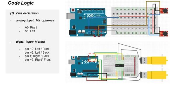

Step 1: Setting Up the Electronics
Build the Circuit as shown above, making sure all parts of the circuit have a common ground connection. We started by placing the H-Bridge in the middle of the Breadboard, straddling the center gap and then connecting the pins appropriately.
Then we connected the microphones using male-female jumper wires. Each microphone's output was connected to one of the Arduino's analog inputs, such as A0 and A1.

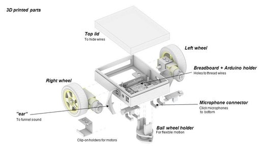

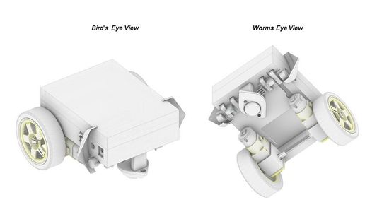

Step 2: Assemble the Robot
In the next step, we prepared the robot chassis. Using Rhino Software, we designed a compact 3D model to accommodate all components and conceal the cables. The Arduino, breadboard, and battery were strategically placed within the chassis to keep the components neatly hidden. We then mounted the DC motors underneath the chassis, connecting them to the wheels on the side. Finally, we positioned the microphones on the chassis to effectively capture sound from different directions.
