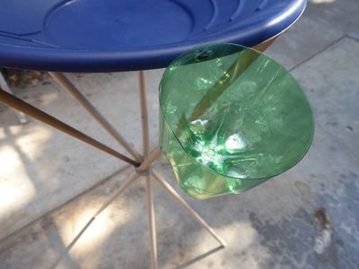

Step 4: Slide Spring Over Dowels
Assemble the tripod by holding the three dowels together and sliding the spring down to about the middle of the dowels. Compress the spring with two fingers as you spread the legs apart. You can position the spring a little above center to allow the legs to spread further apart, which adds to stability but also increases tripping hazard. Hold the tripod open and place the gold pan on top so that the lip of the gold pan catches the pointed ends of all three dowels. Grasp the gold pan firmly by the sides (it helps to hold onto two of the legs while doing this) and jimmy the basin left and right, forward and backward, letting the legs slide up and down the spring to level the wash basin.
Step 5: Towel Rod and Soap Dish Options
If you want to add a stick to hold a towel, you can just scrounge a stick or buy a 1/4-inch diameter dowel and cut it about 18-inches long. Slide the stick into the spring, along side the legs, leaving a couple of inches sticking up past the pointed ends of the dowels. You can also use twist ties to tie a stick to one of the legs, which will also keep the stick from bending too low under the weight of a towel. Or, you can just hang a towel where the three dowels intersect, above the spring.
For a soap dish, cut the top off of a disposable water bottle and use a heated nail to melt two holes near the upper edge. Hold the nail with pliers and heat the nail over a flame until it's hot enough to melt through plastic. Make a pair of holes in lip of the gold pan to match the holes in the soap dish. While you're doing this, melt a few holes in the bottom of the soap dish to let water drain out. Use a twist tie to attach the soap dish to the gold pan.
