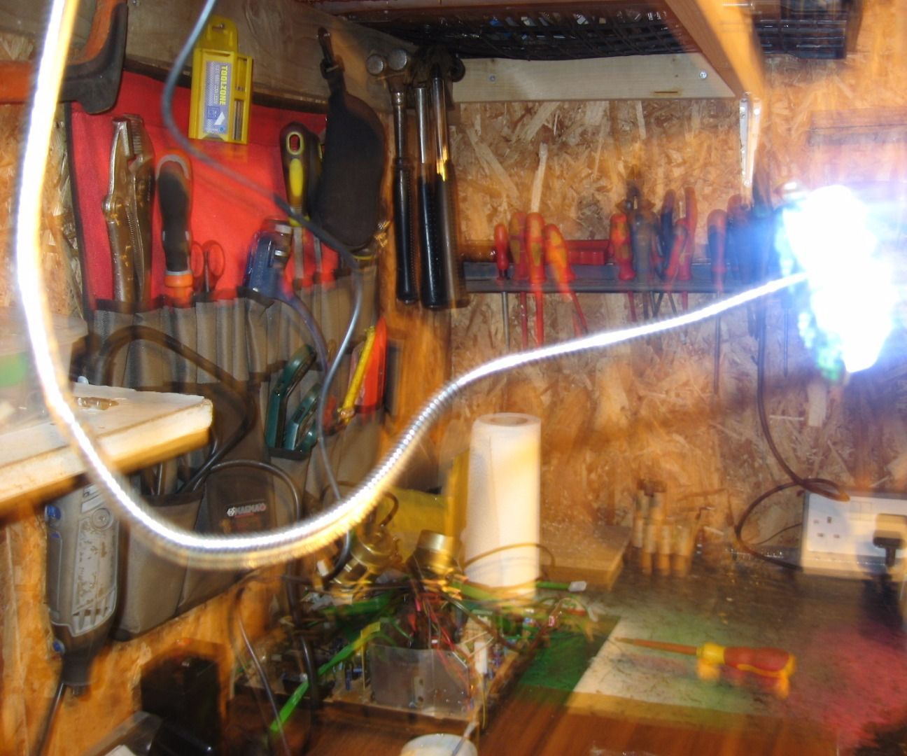

First off we are going to need the outdoor lights preparing for the new led's.
In my case take them down from the ceiling and rip out all the insides out and save for future use,
How i done my light was rip out all the insides and cut the ends off each light and join them together, for the top of the light using a thin strip of metal i drilled holes in the metal and the light cover riveted them together making a good sturdy joint, and for the bottom i used some wood covering the hole bottom of the base of the light scrwing the wood from the other side of the base, and used hot glue to cover the line down the now middle of the light and sanded down so its smooth
To help give some height to the LED's inside the light i used a old laptop screen cover as these have a sort tin foil glued to the inside of the cover to help keep the screen cool so this is a bonus for the LEDs.
After making sure it all fits together, i decided to spray the middle metal strip and base with some silver spray paint i had lying around to help finish it off.
Step 3: Now Step 2
For my next step i started fixing the LEDs strips to the back plate (laptop cover) i also used kapton tape along the end where the connections are to stop the contact between the connection and the LED cooling tin foil, soldering each connection keeping the
R - G - B and the +12v
constant, then after finishing the connections i put hot glue over the connections to give more insulation, on the strip of LEDs you get a 4 prong connection keep this on the and have it where you plan having the IR receiver, drill a hole where you plan to poke the IR receiver through, keep this hole close to your 4 prong connection to make life easier,
you should be ok to keep the IR inside the light if not then move to a safe place outside the light.
Step 4: Almost There Step 3
Find yourself a good 12v adapter i took mine apart and soldered on a DC adaptor that would fit the IR controller, and a new 3 core cable, 0.75 mm will be fine, i cut off the the earth as there is nothing to connect to as this will be classed as double insulated item, my adapter is 1.5 mA, look around on google for what mA adaptor yours should be,drill a little hole on the back to poke out the cable, i used orange cable so its easier to see and i had some laying around lol and then fixed a 3 amp plug top the cable, i also screwed a cable clamp down to stop the cable from being pulled out of the light, then i fixed the LED array to the light and connected it all up and then poked the IR through the hole, then made sure everything was securely fixed down then fix the top down.
Make sure to fix down the 12v block down so it dont rattle around.
Step 5: One Last Thing Step 5
Make some way of hanging your light in the tent, i used cable eyelets and crimped some orange rope in a cross to hang from, i also like this idea as it is usfull to hold the cable when not in use.
Step 6: Play Time
Test your light out, play about with your remote as the last thing you want is getting to your site and finding out your light don't work, try out all the colors as you never know if there are any loose connections or any soldering that's been missed.
