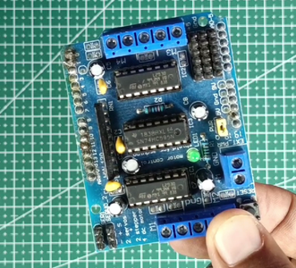

Step 3: Motor Driver and Motor Wiring:
Mount the Shield on Your Arduino Uno
  1. Line up all the pins on the bottom of the L293D shield with the headers on the Uno.
  2. Press down gently until the shield is seated snugly.
DC Motors to the Adafruit L293D Shield Connection:
  1. On the shield, you’ll see four pairs of screw terminals labeled M1, M2, M3, and M4.
  2. Loosen both screws on the M1 terminals.
  3. Insert Motor 1 wire into the left M1 screw and the other wire into the right M1 screw.
  4. Tighten the screws so the wires don’t slip out.
  5. Motor 2M2 terminals
  6. Motor 3M3 terminals
  7. Motor 4M4 terminals
  8. Just the same: loosen, insert each wire into the two screws, then tighten.
