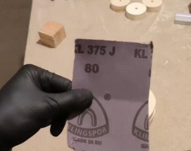

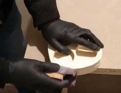

Drill tree holes in one piece of cutted heart and use sanpaper to remove sharp edges.

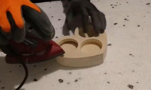

Use the sandpaper to made a final shape of the heart and smooth the edges or use sander.
