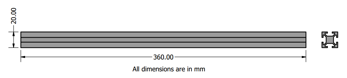

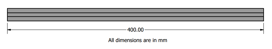

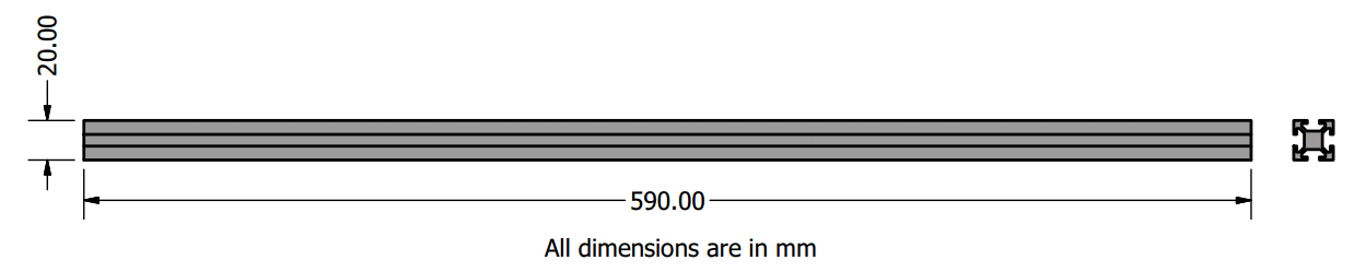

We will be using Aluminium T Slot Extrusions to give it strength and stability. Cut 2020 Aluminium Extrusion of the following lengths:
After cutting them, let's assemble the base and top of the frame. For making them, we will be using two 360mm rod and two 400 mm rod. Assemble them as shown in the figure, using the T Slot 2020 Aluminum Profile L-Shape Bracket.
Now, we have 2 such frames for top and bottom.'
Next, mount the 560mm rods on the corner of the bottom frame as shown in the figure below using T Slot 2020 Aluminum Profile L-Shape Bracket.

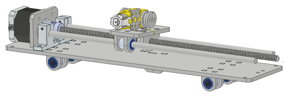

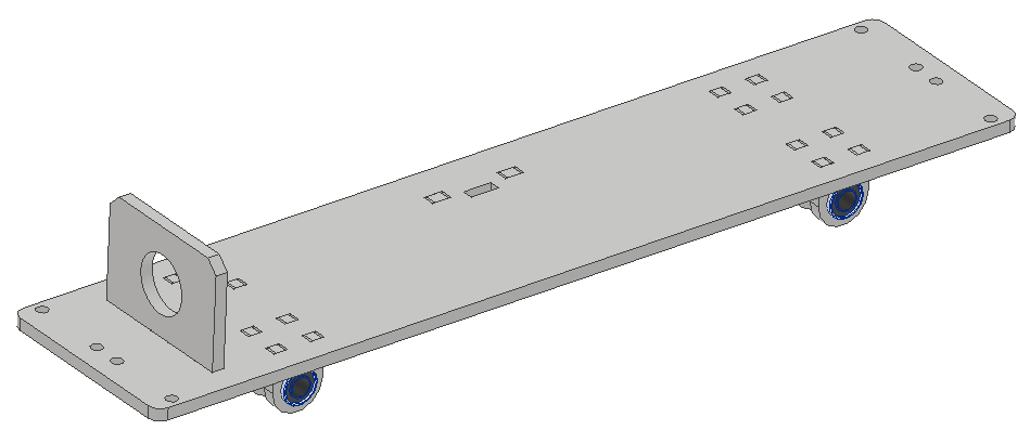

Step 6: Assembling the X Movement Channel
Make for linear bearing holders and attach them to the X Channel Plate as shown in the figure.
Also, mount the Y Channel Lead Screw Nut Holder on the same side.

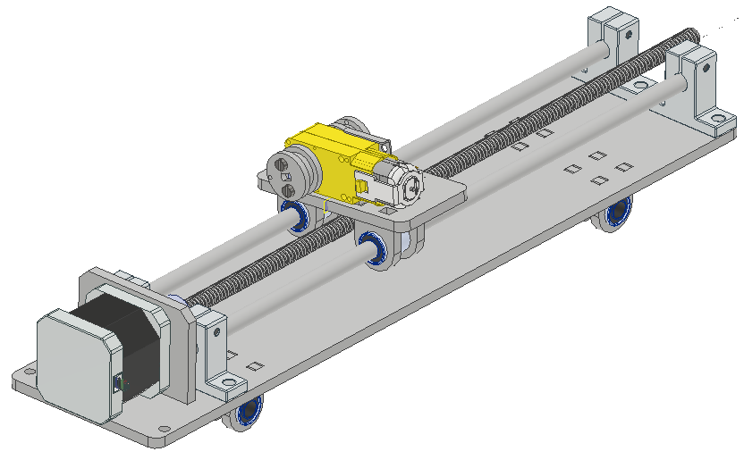

Mount the Stepper Holder for X Channel on the X Channel Plate.
Mount the Stepper Motor to the holder using M3 Bolts.
Mount the Flex Coupler on the shaft of the Motor.
Mount the Lead Screw shaft to the Flex Coupler.
Mount the 8mm End Shaft Holder on the sides of the Stepper Motor.
Place the shaft on the End Shaft Holders.
Slide the Gripper platform as shown in the figure:
Also Mount the Lead Screw Holder.
The final assembly looks like this:

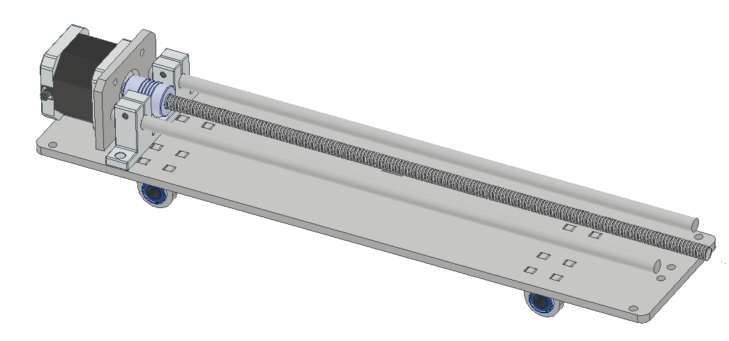

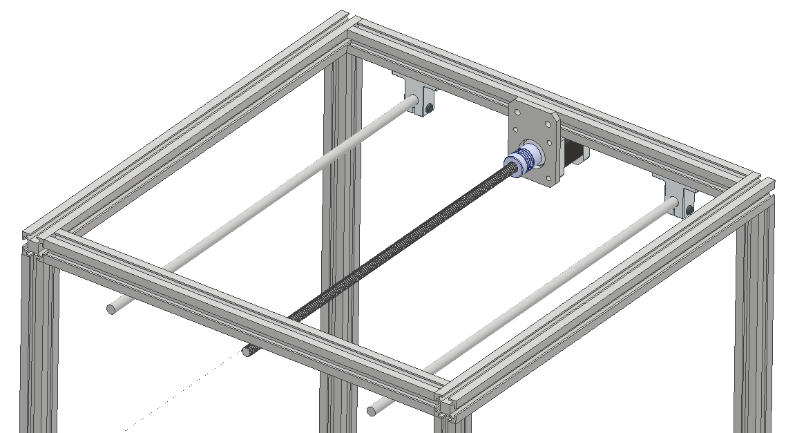

Step 7: Assembling the Y Channel

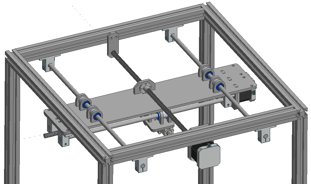

Mount the Stepper Motor in the Y Channel Stepper holder and mount it on one of the sides of the top frame. Also, mount the flexible coupler on the stepper motor shaft.
On the same Aluminium Extrusion mount the End Shaft Support on both sides of the Stepper Motor.

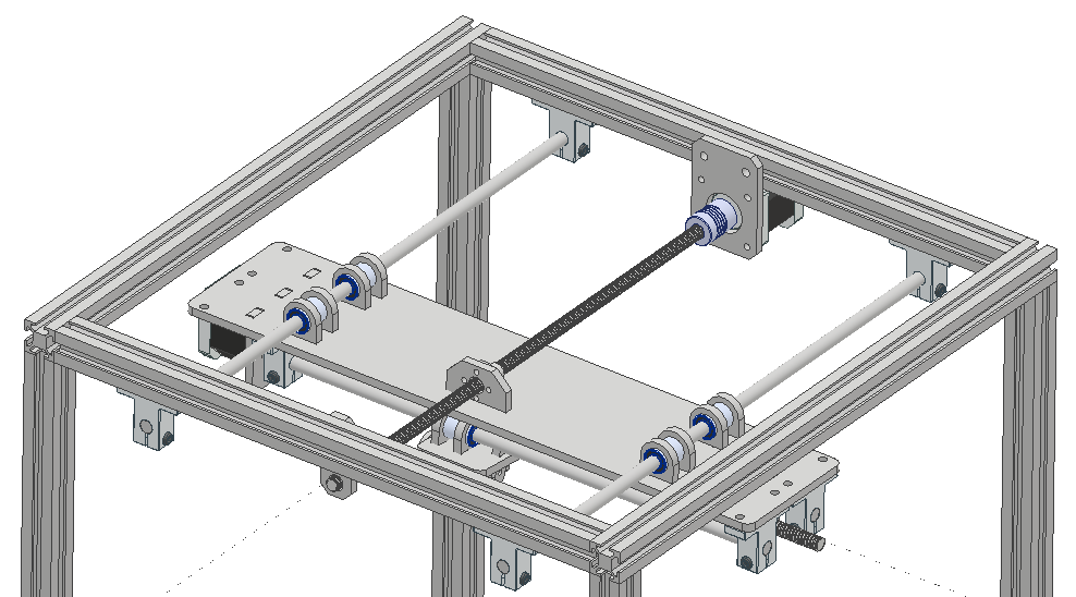

Mount the 8mm rods and the lead screw rod on the End Shaft Support and the flex coupler respectively. Make the end shaft support and stepper motor holder flexible on the Aluminium Extrusion.Slide the X Channel Assembly on the rods
Mount the End Shaft Supports on the other end of the shaft and the Lead Screw Holder.

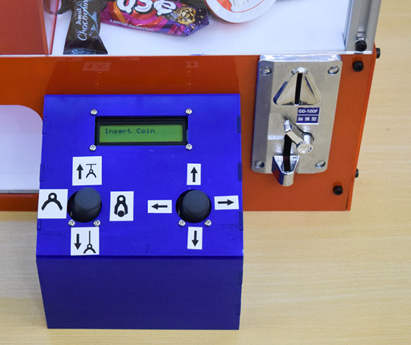

Step 10: Mounting the Coin Counting Machine and Limit Switches
Mount the Coin Counting Machine on Front Bottom Plate using Nut and Bolts that come with it.

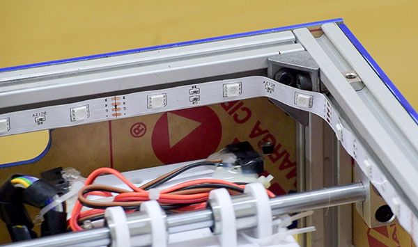

Step 11: The Finishing Touche!
The RGB LED Strip is mounted on the inner parameter of the top frame using Glue or Double Sided Tape. The wire is extended to reach the Bottom of the Claw Machine.

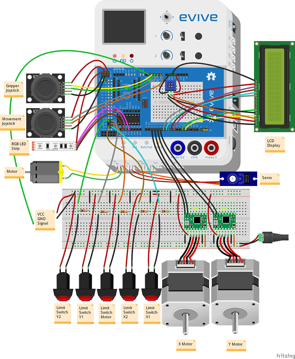

Step 12: Connections and Code:
We are using the following components that we have to connect with evive:
- Joystick
- 2RGB LED Strip
- Motor to Motor Channel 1 of evive
- Servo to Servo Channel 2 of evive
- 5 Limit Switches with Pull Down Configuration
- 2 Stepper Motor
- 2 Stepper Motor Drivers A4988
- 1 1602 LCD Display
- Coin Detecting Machine
- 12V 5A Power Supply
Here is the Fritzing Diagram of the Circuit:
Upload the following Arduino Code:
