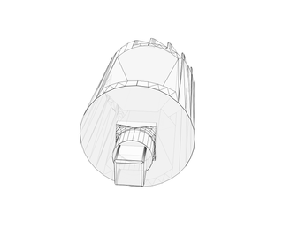

The drum was printed in green ABS material and was scaled down by 0.45 in all planes (x,y,z) to ensure that it fits in the body.

First, trim off the legs of the coin face; this can be done using regular scissors. This is necessary because the legs may not fit into the body. Then, push the knob of the drum through the hole in the center of the coin face. Make sure to push it all the way through. Now that the coin face and drum are attached, glue the knob to the drum. The knob should fit, but will require a tiny amount of gorilla glue in order to stick to the drum. Make sure that the glue does not reach the coin face as this will keep the drum from rotating. Set this aside to dry for approximately two hours.
