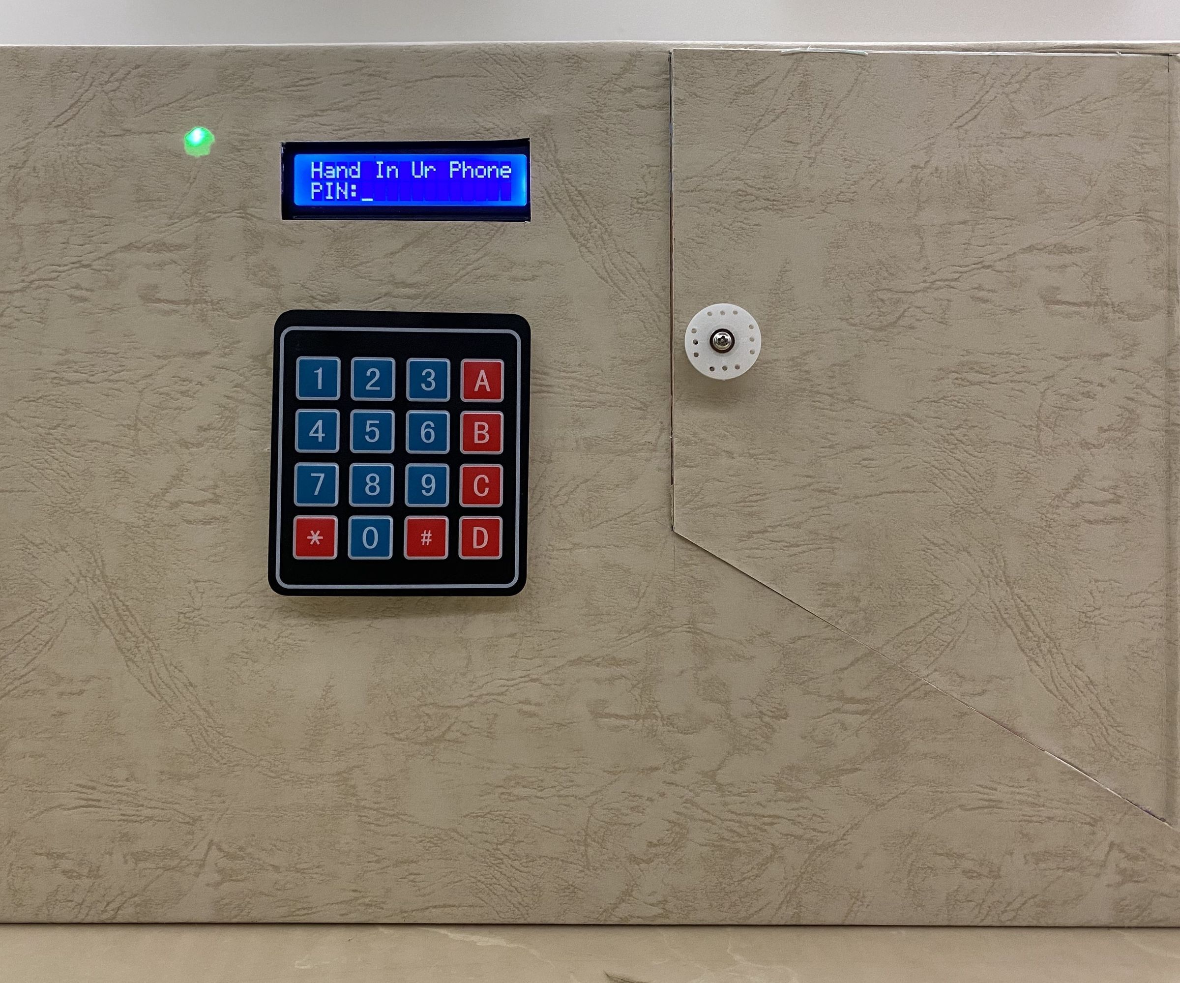

11. Stick board "front, bottom, top, left, and right" together forming a box, remember not to stick the board "back" before finish the whole machine, because it is the place where you place Ardunio in.
12. Stick the things you made in step 10 where candy comes out, on to left front top inside the box, which is the place you cut a hollow in the board "front", the top 12x10 hollow. Also, stick a transparency paper film on the hollow in the board "front", the top 12x10 hollow one, so you can see the amount of candy inside the machine.
13. Stick board "K, L and M" into a "ㄇ" shape but a long one like a track, and board "K and L" will be the two sides, and board "M" will be the middle. After sticking it, stick the whole track into the right side of the machine which the hollow in the board "front", the top 3x3 hollow one, the place where you throw your ball in.
14. Stuck the button onto board "J", and stick board "I and J" right down the track, which when you throw the ball in, it will follow the track and hit the button down below which is board "I", and board "J" is just to guide the ball to go to place using the board "N" to make, prevent the balls to go around the machine.
15. Stick board "O, P, and Q" together, remember to separate the thing on top of the servo and stick it on to board "O", just like pic 15, forming a fence, prevent people from eating the candy secretly.
16. Plug the LEDs into the circle's holes in the broad "front", and make sure the order of LED turns dark is correct, you can look back at the code to check if you plug in the wrong holes.
17. Plug the servo into the rectangle hole 3.5x7 of the board "front", and stuck the fence you made in step 15 onto the servo, stuck it tight, making sure that when the servo moves, the fence will not falls off.
18. Put Arduino into the machine, remember to make sure that all things are stable tightly. Stick the board "back" using high tensile paper tape on to the machine, using tape instead of glue, and stick a lock on to it, because the machine's door would like to be can either open or close, for you to take out the ball, but the door has a lock which only if you know the password you can open the box to take out the ball.
19. Put in the M&M!!!! And put the cup into the machine. (Your machine should be like pic 16)
20. Decorate your Machine!
