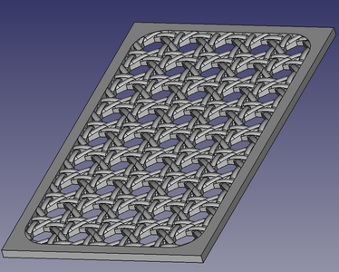

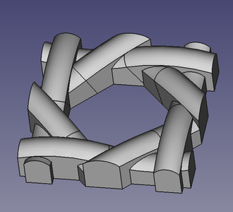

In this Instructables, I am presenting a simple 3D printable pattern that can be used on flat surfaces mimicking the shape of a fairly widely used rattan cane braiding pattern.
This pattern is flat on one side in order to be easily printed on either resin or FDM printers, it is a fairly simple pattern that good looking by itself but extremely attractive when multiplied.
