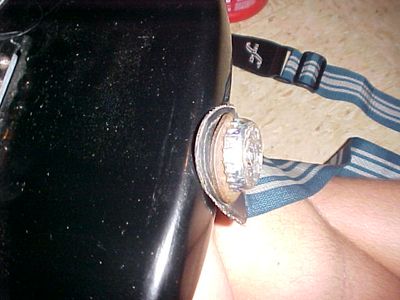

You will need to put together your Cap-Locks now. To put them together, you will need your washers, strap buttons, and bottle caps. The first thing you should do before you begin to assemble your Cap-Locks is put your strap on the strap buttons, if you haven't already.
Afterwards you are going to need to assemble the Cap-Locks in this order
Screw - Bottle Cap - Washer - Strap hooked to the strap buttons.
To do this, you need to:
Take your bottle cap and put the screw through it. Afterwards, you put the screw-cap combo through the washer. The washer must be larger than the bottle cap, if you want to protect your strap. Afterwards, you place the screw-cap-washer combo through the strap button with the strap hooked to it.
You should have something that looks like the diagram.
Repeat for other Cap-Lock.
