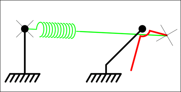

Step 2: Monocle Frame 2 Position Mechanism
The goal of this 2nd mechanism is to be able to hold the lens arm position in 2 different position, it is a bistable mechanism.
First, the 2 ball bearings are pressed into position on the clothespin half that has the mounting points
Then the arm is slid in position in which the 6mm M3 screws can be inserted to catch the ball bearing, /!\ Make sure the screws to not go deeper than the ball bearing, we need to keep the path open for the extension spring to move.
The extension spring can be placed, it is pinned on side by a 12mm M3 screw, on the other side, make a extension of the spring with the steel wire looping around one side of the spring and around the 12mm M3 screw pin. When installing the wire, you should keep a constant tension on the spring to get the mechanism actually working
