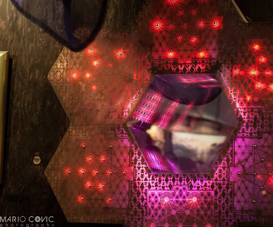

Now we get to have some fun! Your aesthetic is completely up to you and your application, but there are a few things to keep in mind before simply soldering a pcb or other conductive material to an arduino and trying to run some code, specifically, the size and shape of your touch sensitive areas.
First, what may be extremely obvious to some but maybe not others, isolate your touch sensitive areas from the rest of the object. This can be done very easily by incorporating a small island of copper into your design, to act as your "button." This is the area that we will hard wire to our arduino.
If your touch sensitive area is too large, something extremely fun and interesting happens, but this can also be the cause of many headaches and is not a desirable outcome for this project. A capacitive touch sensor with too large a surface area WILL DETECT WITHOUT TOUCH. This is very cool, and can even be utilized for this or other projects, but is a much buggier process to troubleshoot. It may be worth pursuing if activating an object by simply placing your hand a foot above it excites you, I know it gave me quite a bit of fun.
