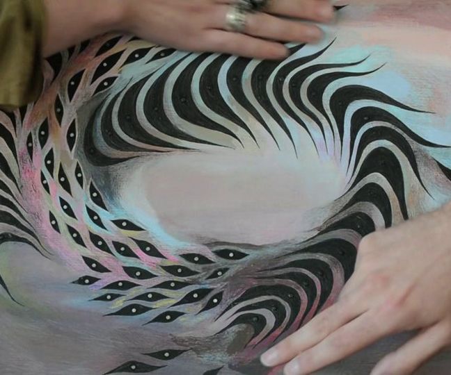

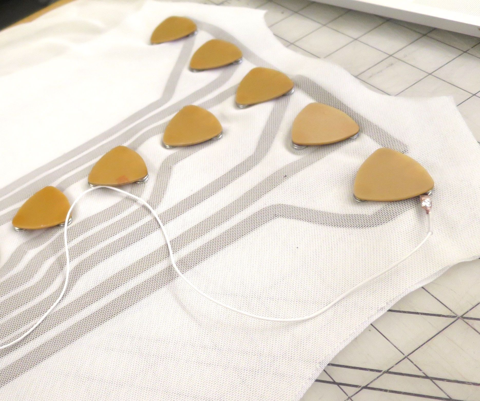

To test and demo the e-textile capacitive wheel I worked on with Rachel Freire, we visualized the sensors' responsiveness with Processing. It was much easier to see what was going on using a visualization rather than just looking at the Serial Monitor in the Arduino IDE.
We used fabric to make our sensors along with a Teensy 3.2, but you could adapt this to work with other sensors and boards. See Rachel's instructable on how to make an e-textile capacitive wheel here.
