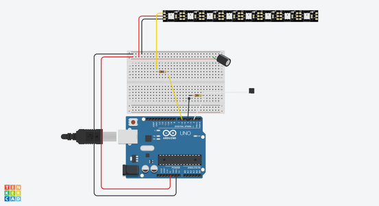

In this step I will walk the viewer through a video of actually building the circuit and connecting it to an arduino, a schematic of it will also be supplied, as the foil tape is not an object in tinkercad, I substituted it with another object and labeled it accordingly.

The file included in this "Notes section" is the Neopixel sketch done in class, however, I did add a random seed into the code which is a deviation from the one presented to us. The code (from Step 2) is well annotated to ensure a novice such as myself can hopefully make sense of what is going on in the Sketch.As listed in the code in Step 2, the duration of the delay can be changed by increasing or decreasing the time (in milliseconds) in line 25 and the randomness can be removed from the sketch by changing "randNumber1,randNumber2,randNumber3" (which are the RGB values in order 1,2,3) to a value between 0 (off) to 255 in line 79.
Please note that I did not have success with the "pixels.clear(); // Set all pixel colors to 'off'" from the mashed sketches, which is why I chose to go with a; "pixels.setPixelColor(i, pixels.Color(0,0,0));// Set all pixel colors to 'off'" to turn the Neopixel strips off at the beginning of the loop and at the end of the loop.
Last thing to note is to run the code in a serial monitor mode to find out where about the measurements are for your particular setup and determine at what point (Value read as shown on the serial monitor) to activate the Neopixel LED's which can be modified in line 63. In this sketch it is set to 1500 as my slightest touch was in the 1500 value range up into the 4K+ range at full contact with the foil tape.
If the strip of 2812B Neopixel LED's are less than or greater than the number used for this project (which was an 8 LED strip) then the number of LED's will have to be updated in line 16.

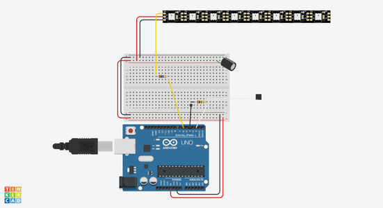

In hind sight after looking at the schematic, pictures and videos the two jumper wires (Red and Black) from the positive and negative rails on both sides of the bread board could be removed and the jumper wires (Red +5V and Black GND) from the Arduino board to the bread board could run directly into the positive and negative rails of the breadboard with the capacitor. (As shown in the updated schematic in this section)
