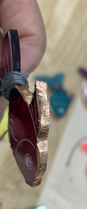

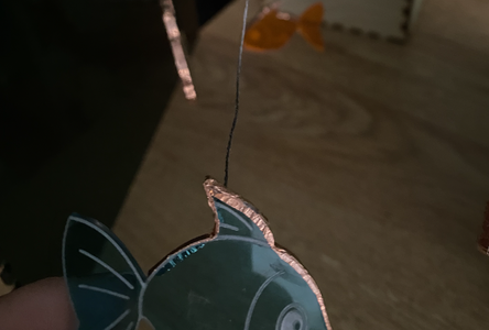

Step 4: Copper Tape
Apply copper tape to the edges of each fish
Step 5: Thread
Glue conductive thread to the top of the fish
- Make sure that the copper tape is touching the conductive wire
