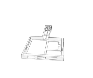

Part #1-----Chassis_35_060215

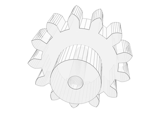

Part #3------Gear_13T32P_051815

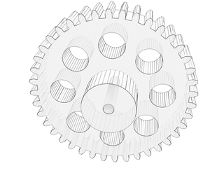

Part #4------Gear_40T32P_051815

Motor Gear and Axle Gear Mate-----1340_Assem
The Chassis and Gears need to be 3D printed.
