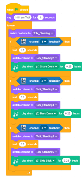

Step 6: Code Your Music
Now, to work within real-time, we need to connect evive to PictoBlox using a USB cable.
You need different costumes of Tobi so that it looks like he is playing the drums. You need to tinker the main costumes and create the sub costumes. You can edit them by clicking on the costume button and directly edit them.
The stick in the sprite’s hand is been taken from the drum sprite. Once done, make the sprites of drum too. We have edited the sprite and colored it blue.
Once done, write the following code in PictoBlox.
Now, as we are going to interact with the sprite we do not need to upload the code (Stage Mode: where you can interact with the sprite in real-time with or without hardware), directly click on the green flag and start playing!
