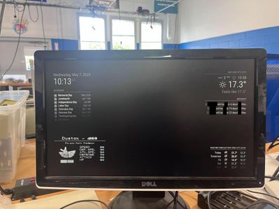

Once you have the files installed, go to the terminal and type in "cd MagicMirror" to access the directory. Then type "npm run start". If you have done everything correctly you should see the default modules for the mirror pop up after some loading time. To exit you can press "ctrl q" to return to the main screen.
Step 3: Customize Your Modules
The default Magic Mirror comes with a few default modules. If you go to the config file under "Magic Mirror" in your files, you'll find "config.js". This is the main customization code for the software. You can change the modules' position to suit your needs. Better yet, you can add others! I went to https://github.com/MagicMirrorOrg/MagicMirror/wiki/3rd-party-modules and installed two that I use: dennisklad's "Birthdays" module and Nolankingdon's "Daily Pokemon" module. Each contained installation information in their sections and were very helpful!

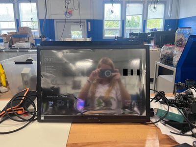

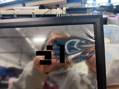

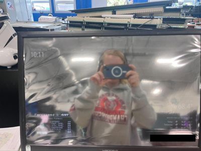

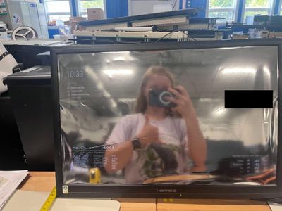

After I had the software situated in a way I liked, I started on my monitor. After cleaning off the screen, I cut out a mirror sheet for the monitor, making sure to leave some extra on the edge to prevent mistakes. I popped off the monitor frame with the help of my instructor, moistened a paper towel and went over the dark side of the sheet, and stuck it on. I also used some double-sided tape to hold down the sheet as I put the frame back over. I then plugged the monitor into my Raspberry Pi, connected to it remotely for easy access, and activated the program.

Try to find a different one-way medium. The one I chose is a little blurry, as it's a privacy window sheet, and not that great of a mirror.

Maybe create or buy a nice frame for the monitor. I think it'd look a lot nicer.
Make sure the monitor that you use has a detachable frame! I tried to use one before the one I settled on because it had a stand, but I could not detach the frame from the monitor to put on the mirror sheet.
