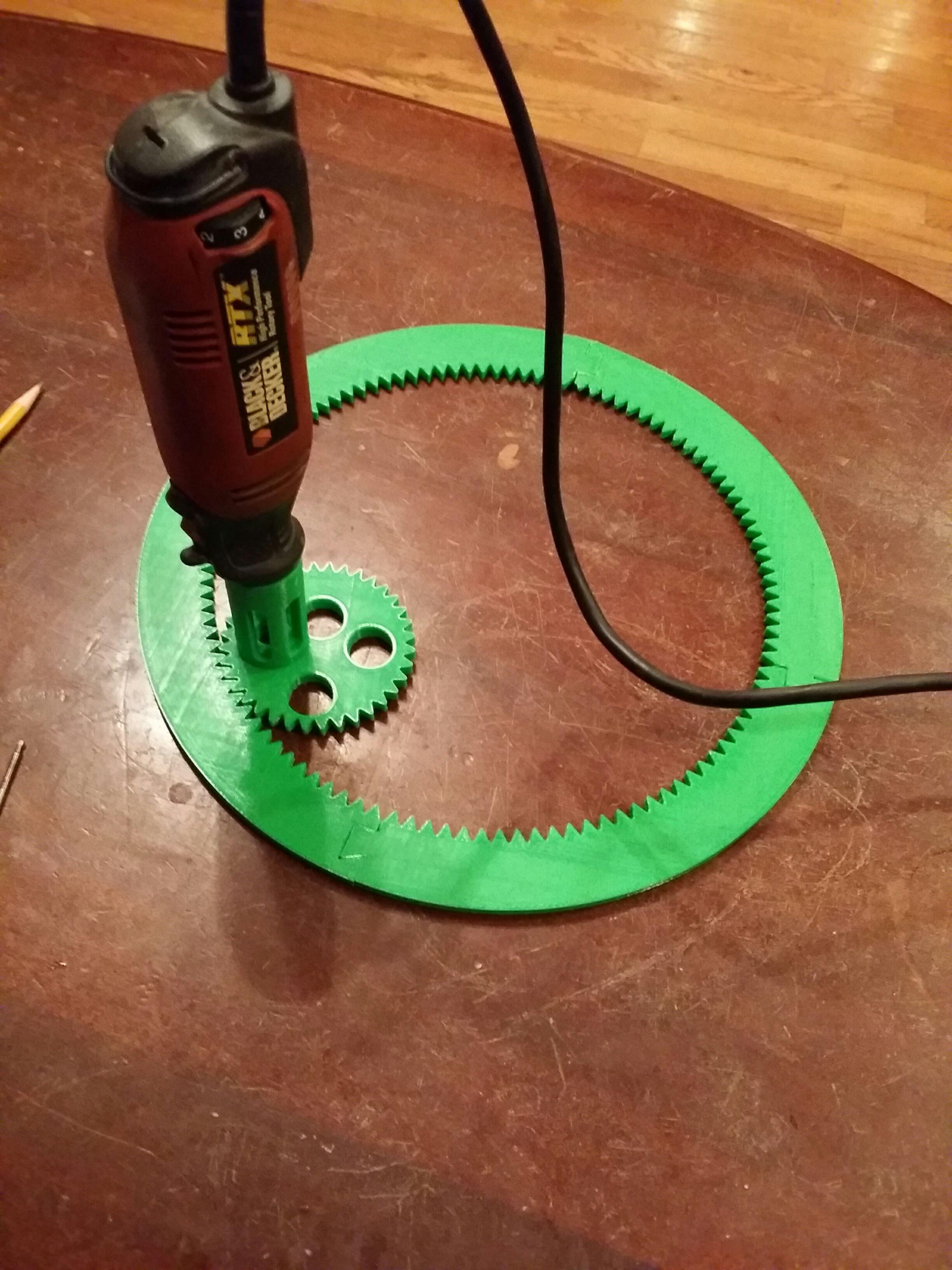

This is a companion project for my 3D Rotating Model Capture Stand, as well as a cell phone mount for any standard tripod.
In the original project (Rotating 3D Model Capture Stand), I designed the camera mount for a DSLR, which worked well enough. However, what will most likely work better is using a cell phone to get the pictures for the 3D model captures straight into the Autodesk 123D Catch app. That led to this Instructable since I didn't find the design I was looking for. At first I was looking for the simplest mount I could possibly find, which eventually evolved into this...
