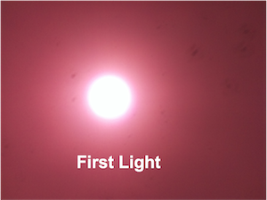

Just to note, the first 50mm example has a red tint because it was taken using a Thousand Oaks filter. The other three were taken with the Baader filter. Note also that the four images above were taken using the Raspbery Pi Camera Module and the libcamera software that will be described in a section below.

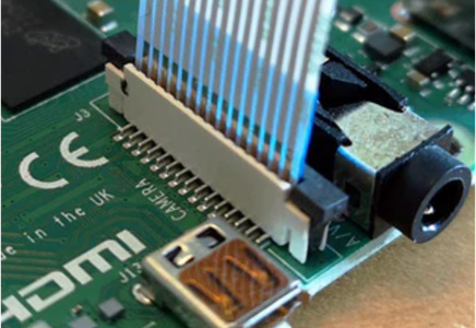

The camera usually comes with the ribbon cable plugged in. As a first step, disconnect the ribbon cable from the camera board and insert it into the correct connector on the RPi board. This is because the connector on the RPi will become inaccessible after the next step. I cannot emphasize taking care to make sure you put the right side of the cable into the correct connector. Typically the correct orientation is with the blue part of the ribbon cable facing towards the USB ports. I suggest you check out instructions about this if your first time, because it is easy to insert backwards. A picture of the correct orientation is shown above. The RPi Camera Forms say over and over this step is the biggest source of the camera not working by first time builders. https://projects.raspberrypi.org/en/projects/getting-started-with-picamera/2.I proved that point to be true!
