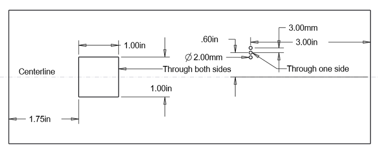

The PIR sensors need to protrude out the side of the box to work. Since I decided to use two PIR sensors I decided to place one out each side. Their position is arbitrary but mine are placed on the horizontal centerline (Figure provided) and 1.75 inch from the closest side. The hole to fit the PIR sensors are 1 x 1 inch.
For the single IR sensor its position is arbitrary as well. Depending on where the box is placed should be considered when placing the sensor. For my application, the left side (side oriented towards house) is chosen for the for the IR sensor for a direct line of sight to the TV remote (so device can be turned on/off). Three 2mm holes were drilled at locations shown in attached Figure.
Both the PIR and IR sensors were hot glued in. Special attention was given to prevent water from entering the box.
For the wooden insert a section of 1/4 inch thick wood was quickly measured and cut to be able to fit inside. Give the sections around the PIR sensors in the walls plenty of room to avoid collisions while later inserting the electrical board. The electrical components were then placed on top of the plank and their outlines traced with a sharpie, including their holes. The holes were drilled out to accommodate 4 mm bolts for the arduino and relay, 6 mm bolts for voltage step down, and 1/4 inch bolt for the horn hole. After programming the battery will sit under this board.
