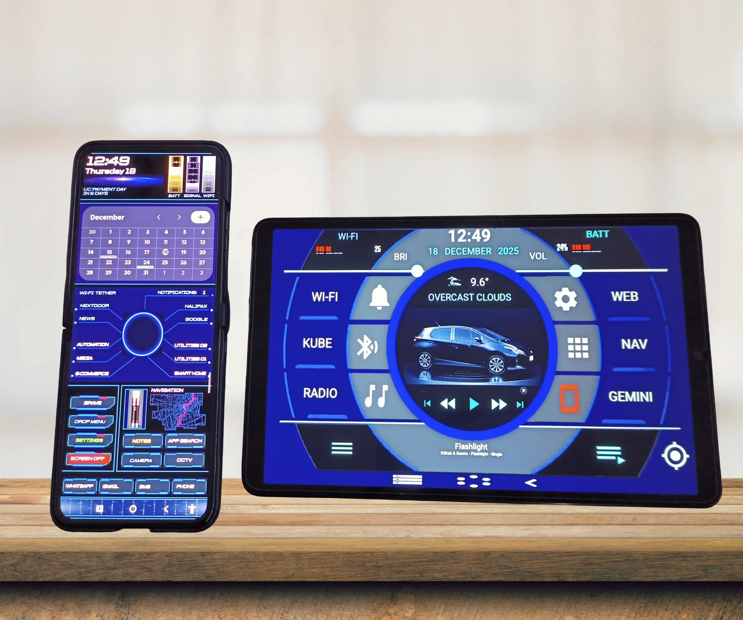

An additional upgrade is a custom-installed tablet system that replaces the traditional rear view mirror. This acts as a video mirror tied into the dash cams, navigation screen, media player, and vehicle diagnostics display, all driven by my own UI designs and control layout to make it look smart yet easy to see and use while driving. The result is a small, economical car that now feels considered, modern, distinctly mine and given it a new lease of life.

Tablet Rear View Mirror and Custom UI: A tablet is used as a digital rear view mirror tied into the dash cams along with a navigation system, media player, and vehicle diagnostics and display. It’s fitted inside a silicone case, with four small holes drilled to allow zip ties to secure it to the existing mirror mount. The tablet can be easily removed when needed. Power is routed neatly along the roof lining, down behind the A-pillar trim, and into the car’s charging port. The tablet runs a custom DIY user interface which I made is stylish, easily readable and usable, and practical while driving which I’ve detailed in another Instructable I published.
