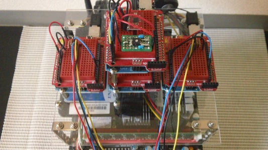

Carefully check the picture, fourth Arduino is attached above central one.

Finally, Hinoshizuku1(3-axis gyro ITG-3200) is applied for Strawberry version.
In Strawberry version, combination of Tachometers and azimuth measurement is applied.
Fourth Arduino is attached above central Arduino.
I applied Low Dropout Voltage Regulator NJM2845DL1-33 to supply accurate 3.3V to ITG-3200.
Fourth Arduino code is same as Hinoshizuku1. (FreeIMU_A.pde)
